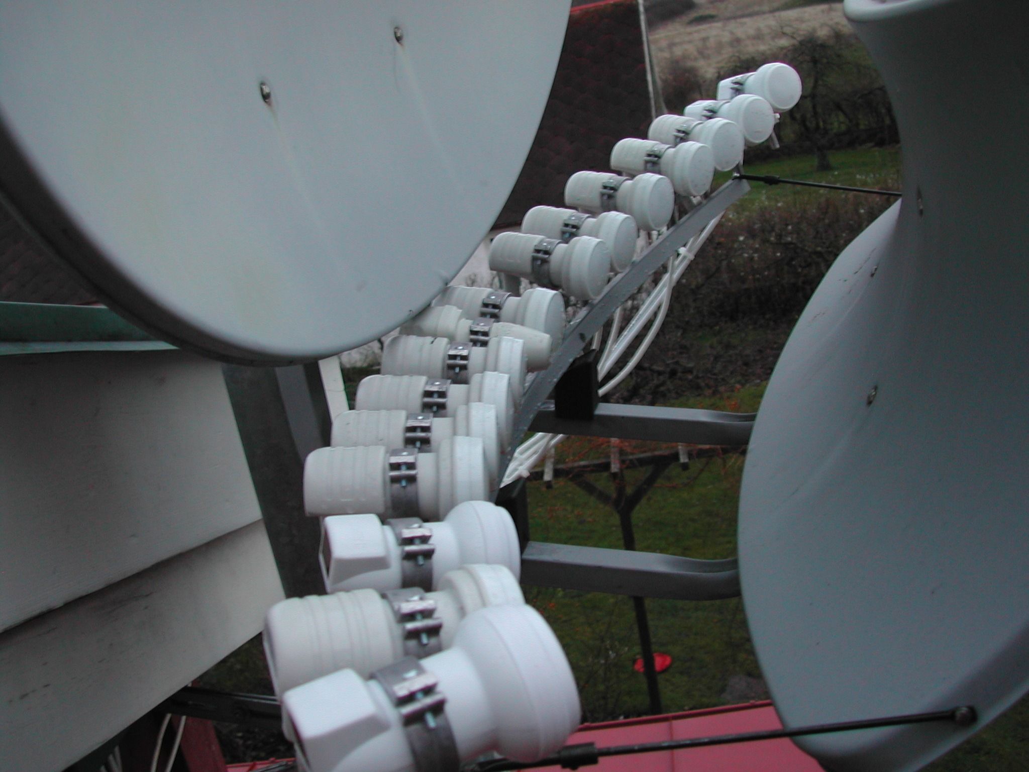

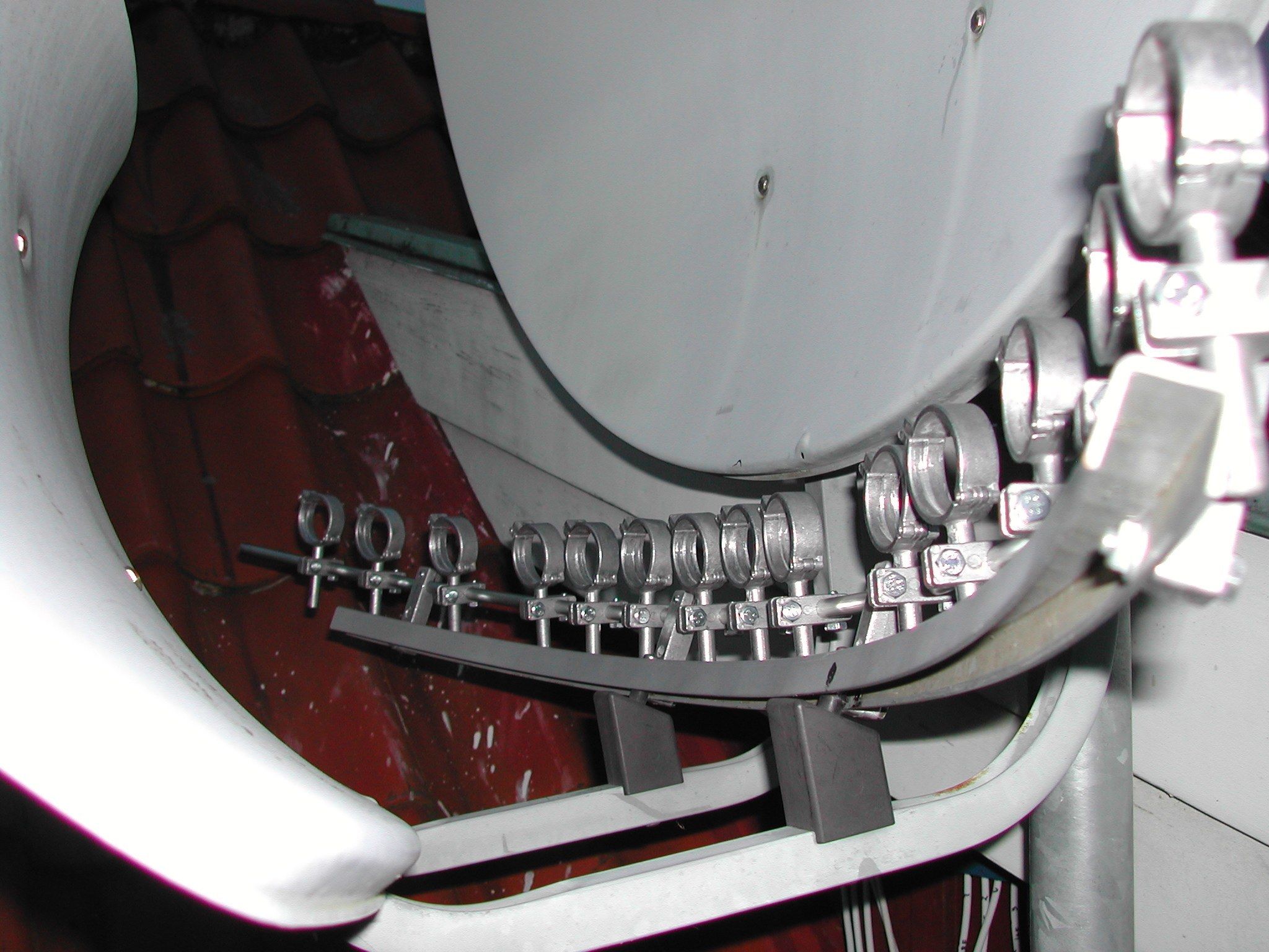

The weakest part of the T90 is the LNB rail, they are a pain to tweak exactly as the plastic holders aren't stabile enough.
My friend did a new LNB rail for the T90 as you can see from the picture below and it's very nice.
2 degree spacing is no problem with the new rail setup.

Likvid, those are really nice pictures! You think your friend would make me 3 of those Rails? And include about 50 lnb Holders to go with them? That would be a Good Thing for me!

Looks great, and very professional! From the angle of the pictures, it seems that setup is getting a bit more than the 40 degree arc in the T-90 original specs. Is that so?
