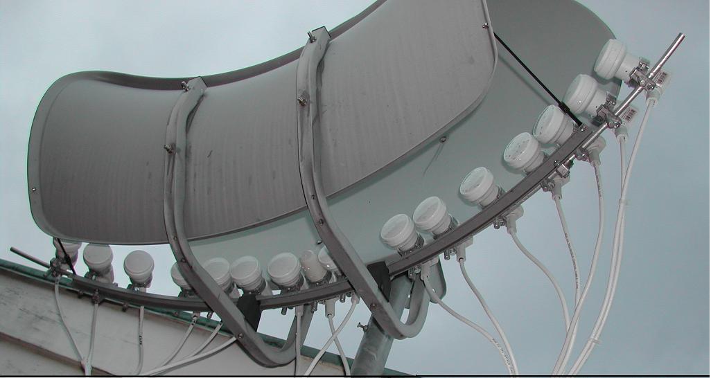

Very nice!!! Any chance on getting a parts list? I too am wondering about the arc setup. What sats is he getting and what is his true south sat?
He covers the arc between 33 East to 22 West.
He is not selling these parts yet and i don't know if he will as he only made one.

Looks great, and very professional! From the angle of the pictures, it seems that setup is getting a bit more than the 40 degree arc in the T-90 original specs. Is that so?
I'm looking at 47 degrees right now, from 82 through to 129 west and didn't have a problem doing it. I know I could squeeze in more if I wanted. The potential trouble is that it will squeeze the LNBs you have now closer together when you squeeze in more of the arc. You may have a problem using standard width LNBs depending on what sats you want because of many being 2 degrees apart.
Sounds reasonable regarding the spacing. I've heard that one can squeeze a bit more than 40 degrees from a T-90, and Likvid's pictures show a very professional-looking job :)

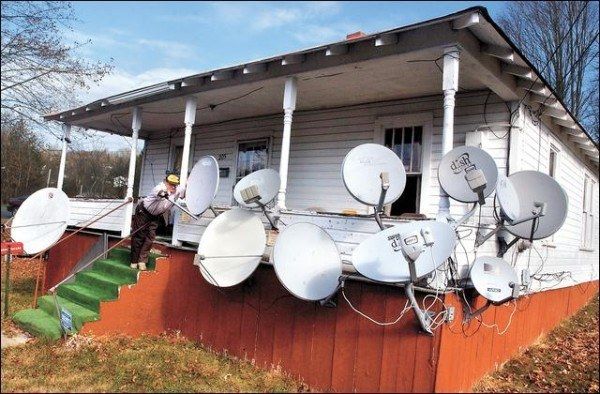

Or if you don't like the T90 check out the picture for another way to go. :D
This guy obviously enjoys an outrageously high WAF... :D

Anyone who wants to build the rail with the LNB holders in the picture above can DIY.
My friend wasn't that as clever as he bought, the hardware is freely available when i searched Ebay in Germany.
You can buy the LNB holders from Ebay.de
VIALUNA ODZ 130 - 2-4 Multifeed 3-30° f 80/90/100/110er bei eBay.de: Sat-Zubehör (endet 08.02.08 23:24:00 MEZ)
It comes in kit of 4 holders.
For the aluminium rail you can just walk into any hardware store or workshop and buy the aluminium rail with whatever length you want and be sure you also buy the corrent dimension of the rail so the LNB holders can slide on to it.
