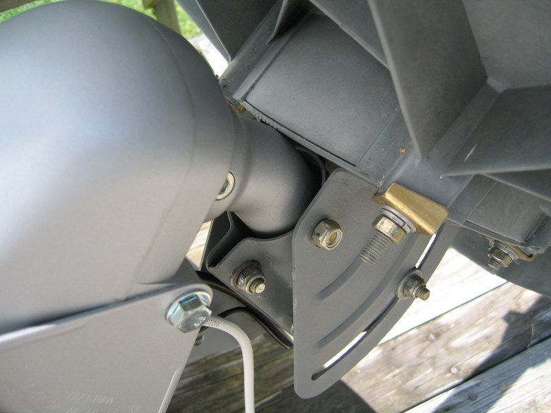

Guys - I can't believe this actually worked so I have to brag about it :D

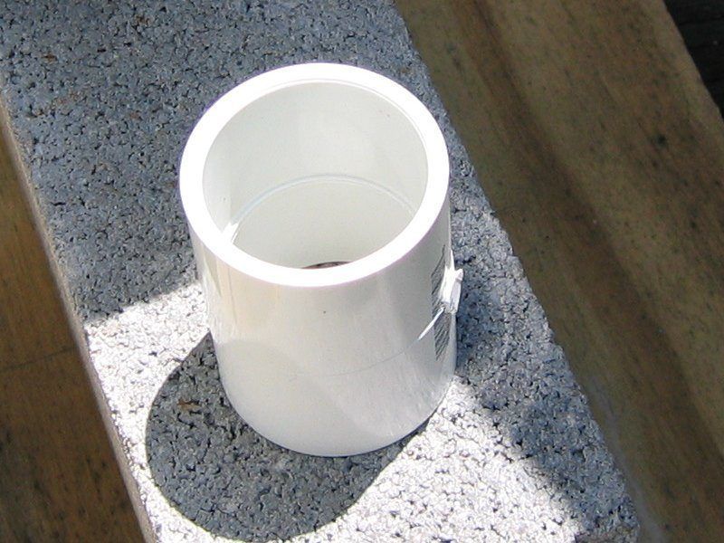

Problem: Just bought an SG2100 motor with a 1 5/8" shaft, but my Globecast dish mounts on a 2" pole.
Solution: Go down to Lowes lumber and pick up a 56 cent 1 1/2" pvc connector - amazingly it's just the right size: about 1 5/8" on the inside and about 2" outside diameter. Trim off the mold flashing and ream out the ridge on the inside and it is a very tight fit on the motor. Cut a slot lengthwise down the side so it can expand a little bit and also let the outter clamp squeeze down on the motor shaft. It works perfectly and only costs 56 cents, so I don't have to buy a whole 'nother dish mount. Luckily, with the dish angle set for my 30 - 5.8 = 24.2 degrees, the dish *just about* hits the motor shaft. Pictures attached.
Nice work!
I did something similar with my 2 3/8" primestar / Channelmaster mount.
If you have any problems with your PVC adaptor down the road (I doubt you will), DMS sells a 50mm downtube for the SG2100 that would be pretty much perfect for you.

While I managed to get the motorized dish working with the spacer, I'm still learning how best to aim it. As you know there is the main polar elevation set with the motor bracket, and a small 30 - 6 = 24 declination set with the dish bracket. Which angle is the best to 'tweak' on your due south satellite? It appears that you can tweak one up a degree and the other down a degree and still hit the due south OK, but which matters most for getting the whole arc right? I was able to hit everything from 74 to 103 ok, except the PBS stuff at 87 wasn't optimum.
The motor elevation should NEVER be altered (make sure the pole/mast is exactly level), only the dish elevation should be changed to peak in the signal :)
