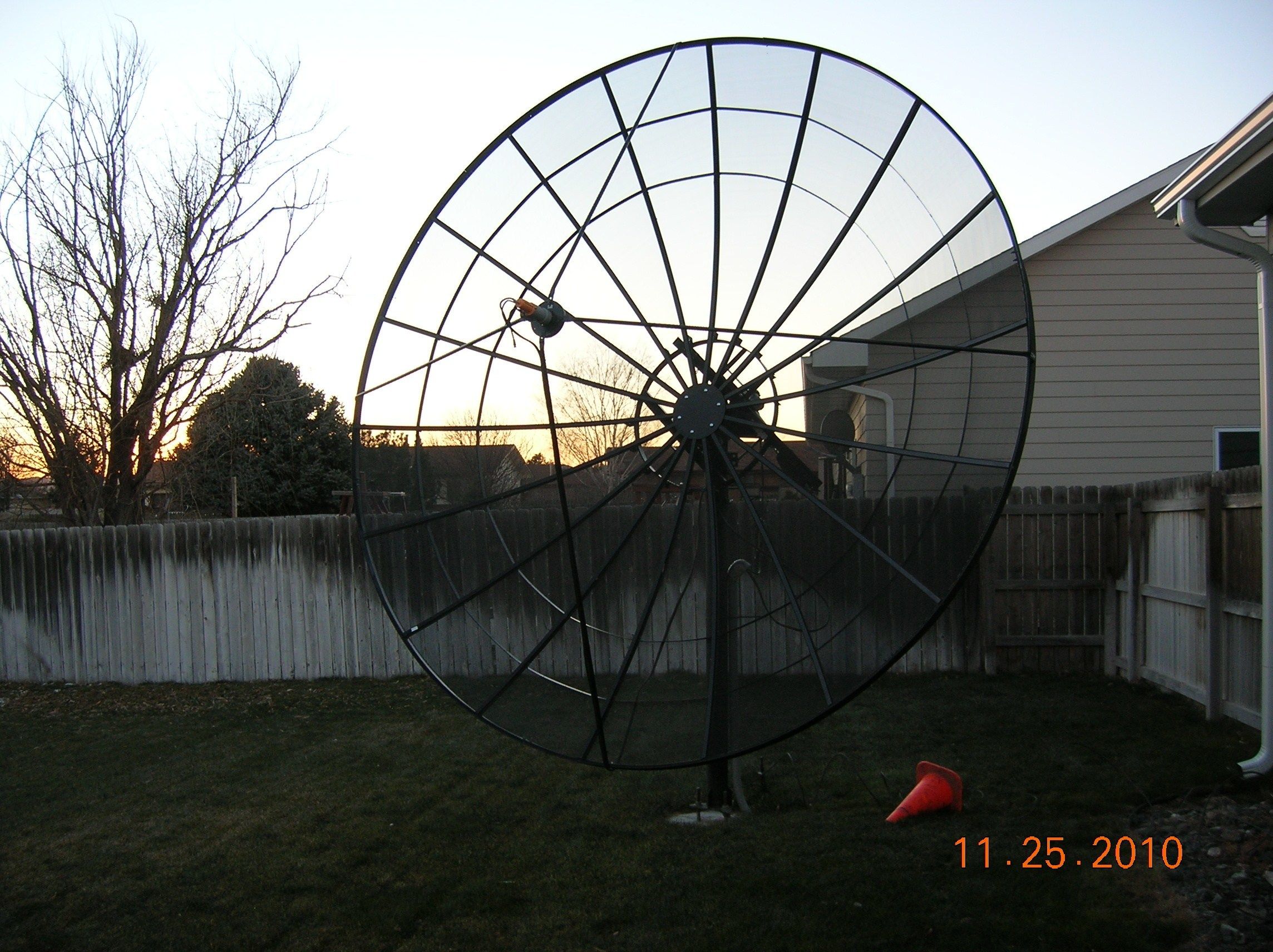

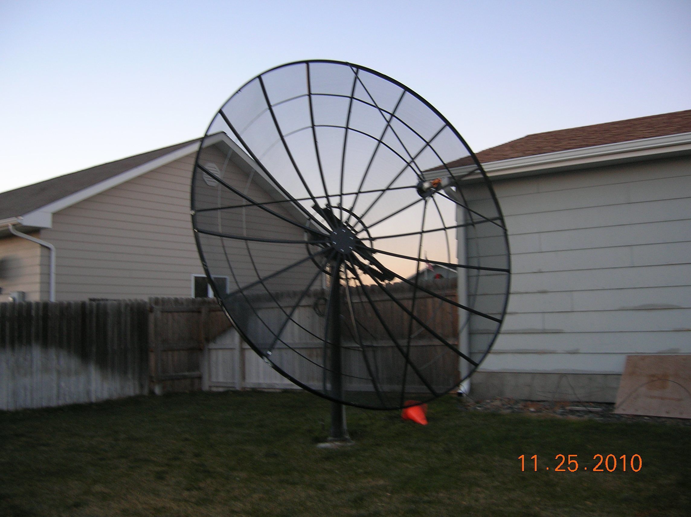

I'm getting it here. Yes, some movies are in english with spanish subtitles. Also, my wife is happy that she can see Teletica7 from her home country (Costa Rica). But, the look angle from here is about 13 degrees. I've included photos of the dish pointing at IS-11. Believe or not, I can see NSS806 from here also.

Johnny,
That is a huge dish, looks great. Nice job at getting that sat. I am envious that you can get that TP. What LNB are you using. And I'll ask again, if you will, where are you located.
Johnny,
I'm in western Nebraska. LNB is DMX741. I guess a big dish helps and it appears that I did a good job on alignment.
