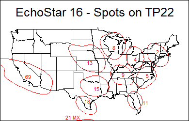

How far do spot beams cover? I'm in Southern Ohio in the Huntington/ Charleston dma, would I be able to get Cleveland locals down here?
The eastern arc Cleveland HD spot beam (22s4) is fairly large and likely does cover your location. The western arc HD beam on 129 is much smaller.

Exactly, there is a way to test this for yourself. Cleveland HD locals are on 61.5 transponder 22. If you have a Hopper you can press Home three times then go down to Dish, next select 61.5 for satellite and then change transponder to 22. If it goes to a lock and shows green along with it saying Spotbeam, you are golden.
