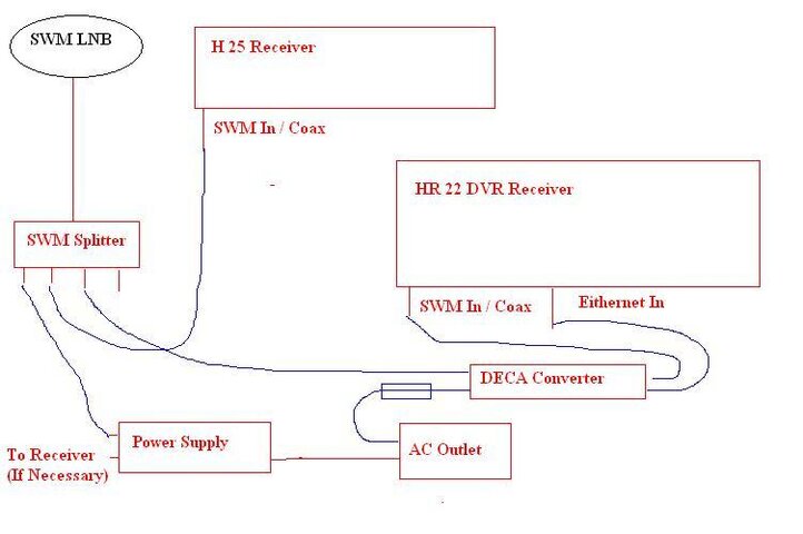

Someone correct me if im wrong, you need the following...
#1 SWM LNB
#2 Cinema Connection Kit
#3 DECA converter to convert the coax network to an eithernet network.

It has to communicate through the coaxial via Deca and Swim setup
The Hr22 needs a deca adapter connected to one of the ethernet ports on the Hr22 and you can connect to your router on the other ethernet port if you want on demand, Pandora or Youtube.

The only need for #2 would be for on demand, cinema plus, pandora, and you tube. For strictly tv and MRV the only thing that's needed is a SWM LNB (which if an H25 is on the system it is SWM already) and a deca cenverter for the HR22
