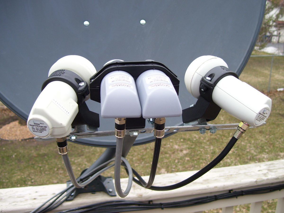

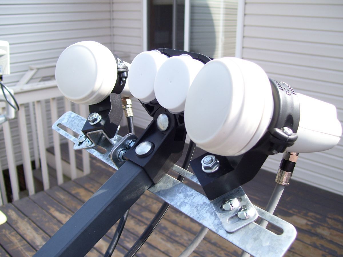

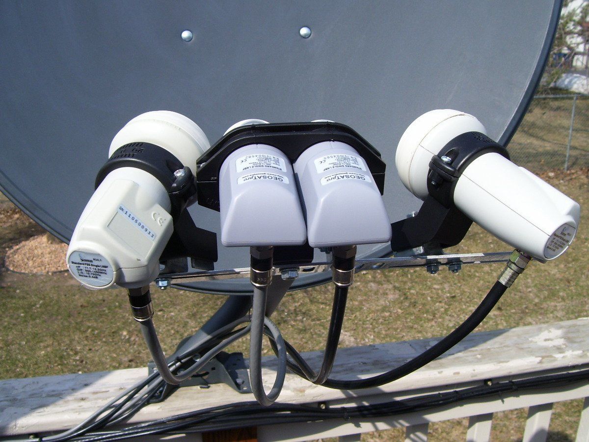

I used one of those on my 90cm dish. I had one of the Glorystar dual LNB setups which allowed me to get 93/97 and then I used 2 of those setups to add 89W and 103W
The advantage of Azteca & ABCNews is they are very strong signals so you may want to try 97W first then add a LNB for 93W.
see pics
see pics

jay
see pics
