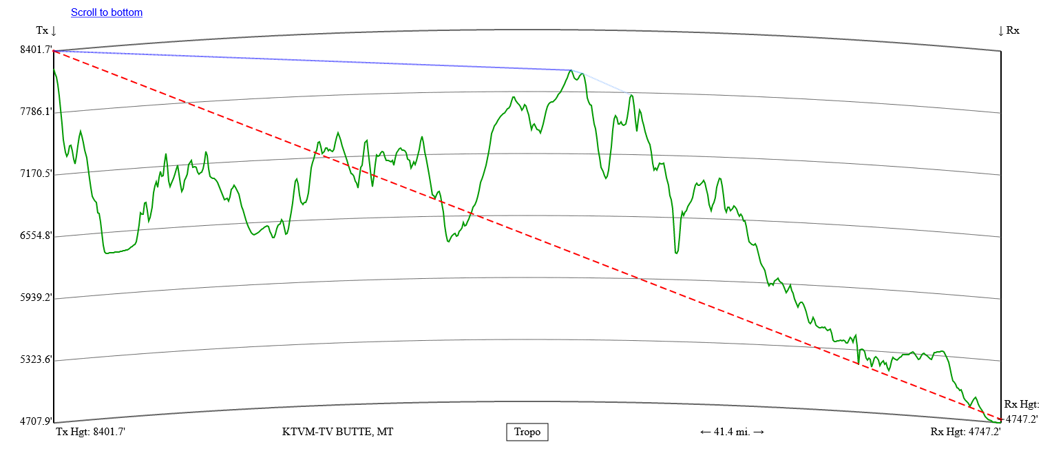

OUCH.
Those channels are both LOW VHF, which means you NEED an antenna capable of getting LOW Vhf. Those types are HUGE, and you likely can't stack them. Most VHF antennas that are easy to get are only HIGH Vhf.
She has NO chance of getting those, except by occasional Tropo. IF you click on the mileage hyperlinks, here's what you are fighting. the signal has to go THROUGH the mountain range. The red dotted line is the path the signal would need to get to her house.
