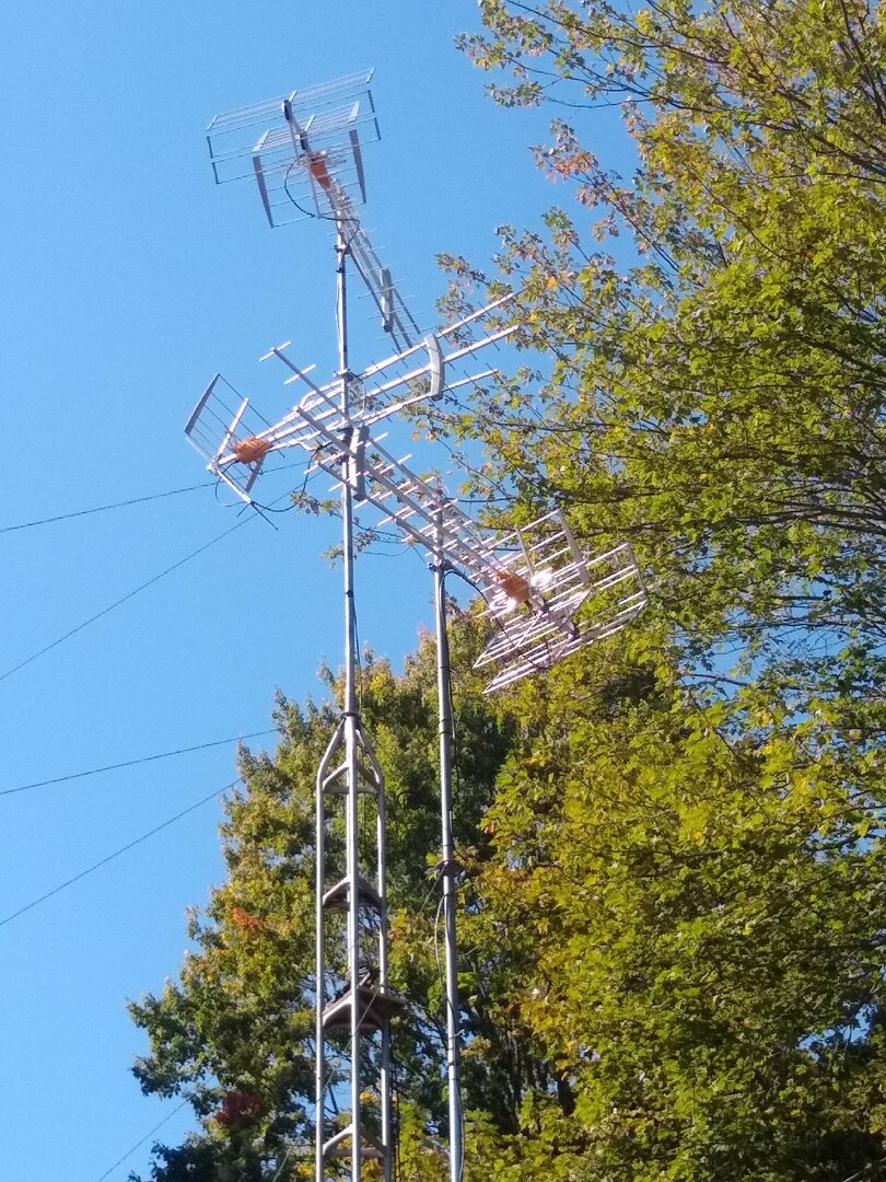

Not sure, but the long beam should be on the top as you said. There must be a good reason, otherwise they wouldn't stress it. As for my experience with them, this is my present setup as of 3 weeks ago. 3 markets, as I combine them with a Televes SmartKom device:
Leaves are falling mine is assembled and ready to go up in a week or two. The smaller Televes pointing south to the lighthouse tower and the big one North/ Norteast and mixed through the smartKom. Love these antennas!

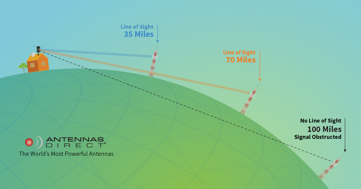

Iam 30 miles from most of the towers and 50 miles from the two farthest. The area is flat
Over 30 miles, this is especially not true on this planet.
The highest point in Florida is only 345 feet above sea level. My towers are half way between Pensacola, FL and Mobile, AL, which is the highest point between the two cities. Obviously, our planet is not flat, but their is not much elevation in 30 miles, especially in Florida..
I live in Florida, I know that, but the earth still curves no matter what.
