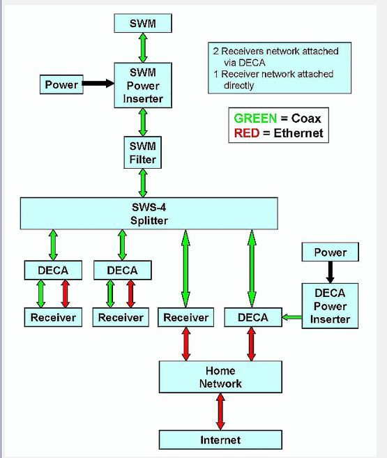

Here are your basic options. As you can see there is no internet connection at all in the picture as this is just the DirecTV portion. The internet/network connection comes into play in each of your apartments separately and never connects to each other's set up.
Think of each DirecTV receiver like a computer on a wired network. Each of you have your own internet modem connected to a wireless/wired router then that connected to your DirecTV receivers. Those receivers are configured in the receiver setup on the same network once you have Whole Home DVR added to your account.

My apartment, plus two others are all on the same dish. With each apartment having one DVR (two tuners) + one additional tuner in another room, that's a total of 9. The SWM dish they put up will only support 8. The dish they took down and threw away would have supported an unlimited number of tuners.
My understanding is that the internet connection goes to the SWiM splitter, as in the attached diagram. Thus all apartments must use my internet connection, unless someone can explain how to set up each apartment separately. And nobody has really explained how to avoid sharing my DVR with the other apartments, either.
You can use BS Filters to accomplish not sharing dvrs. I'm thinking, although I don't truly know, that this would solve the internet issue as well.
No do not follow your diagram. Follow mine. It will make things much easier for you and will let ya'll use your own internet connection.
