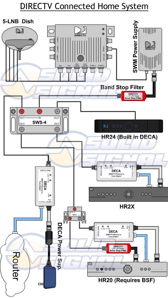

That's interesting. So there is a wireless method, that's the first I've heard of that. So if you use the wireless adapters shown in the diagram, you don't need the DECA boxes at all, either for on-demand or whole house DVR? Are the band stop filters required?
You can do this, but you would have to run ethernet(either wired or wireless adapter) to all of your receivers. If you use DECA, you would only have to run one coax cable from your splitter to your router, as shown in this diagram.
You can't use wireless adapters for supported MRV. You must use the broadband adapter. All that is required is an additional cable run from the splitter (the one for your apartment) to wherever your router is, the adapter connects there with a power supply.
If I were you, I would have a slimeline reinstalled and go with a SWiM 16 or even a SWiM 32 multiswitch. You would run 1x4 green labeled splitters off the multiswitch, on to each apartment. Then you would have extra ports in the splitter for the broadband DECA and each receiver. Plus one more for future use. A bandstop filter will go between each 1x4 and the SWiM16/32 to prevent MRV and Internet from being shared between apartments.
I see. So I guess Netflush920's diagram is not a viable solution if you are using MRV unless the receiver happens to be located next to the router.
That diagram is kind of what I'm envisioning at this point. But why is there a BS filter and 2 coax between the HR 20 and the splitter?
