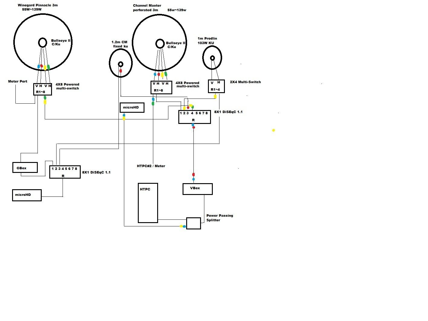

Here's a picture of my setup.
The "power passing splitter"makes more sense, as you can use ether receiver to control the motor.
Just cant really, use both same time, I will have to live with that.
