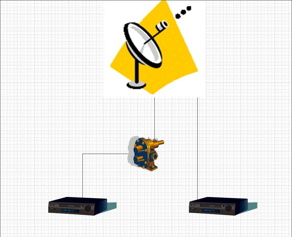

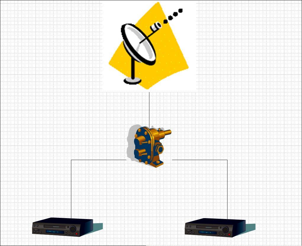

I have a fortec Dual universal LNBF (FSKU-2v) going into my digipower SG-2100 motor and then into my receiver. At the moment I have only one Classic NA receiver and another on the way. Since there is only one connection on the motor for one LNB, is it safe to say that the second receiver has to be directly connected to the LNB? The first pic is of what my layout will be once I get the second receiver. The second pic is what I asking if it can be done.

I have daisychained one receiver to the other and can control the motor from both receivers one at a time only.
Reinhold.
The only drawback to using the loop out method instead of a dual output LNB would be when both receivers are used at the same time the slave box will have to watch the same polarity as the master box.
Do the best of both worlds.... one cable from the slave to the dual output lnb, one cable from the loop out to the slave, connected to a cable switchbox to switch back and forth.
Just to add to my comments above, for the slave receiver to have full control of the motor (and with both polarities) you will have to turn the master receiver off (STAND BY) with the remote only. Otherwise, the master receiver will be the only one to control the motor and polarity.

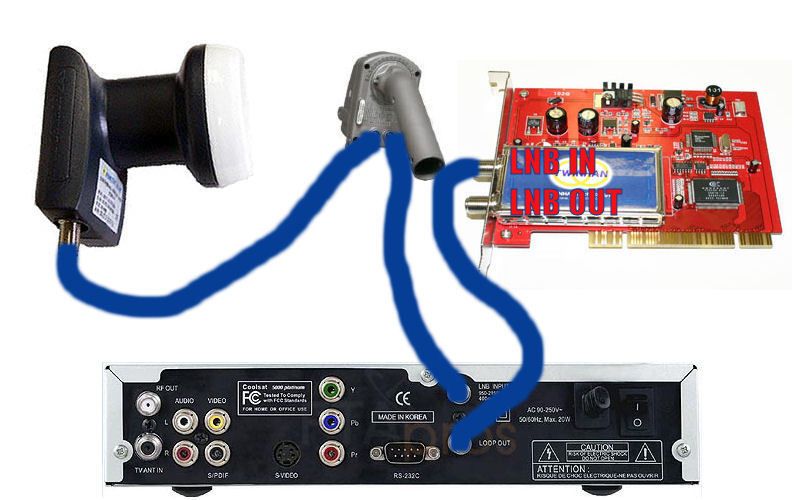

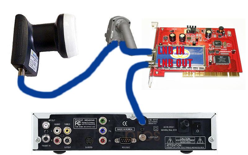

I have questions about mine too.. I'm not that great writing in English, at least I try cuz I'm deaf :) so I decided to draw the pictures which one will work. Anyway, I don't want to unscrew/screw the coax cable back and forth to use either my TwinHan 102g or Coolsat 5k.. I would like to leave it at once. I don't want to destroy one of these equipment! :rolleyes: So, all of these equipment is exactly I have now.
Here's picture which one it will work..?

Both will work the same. The only difference is the receiver hooked to the motor can see both polarities whereas the 2nd will only see the same polarity if both are on
My preference is 2nd picture where the Fortec controls everything
Great!! I'll use 2nd picture.. Hopefully, that will give me less headache!! :)
