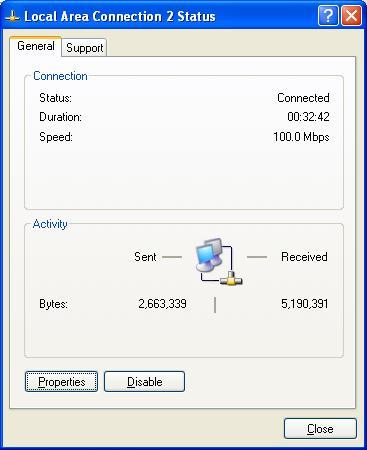

EVERYONE'S LOCAL AREA CONNECTION says 100 mbps. It's the speed of the ethernet cable!!!
Go here, http://www.dslreports.com/stest, and post the results.
View the attached file. MINE SAYS 100 mbps too!
