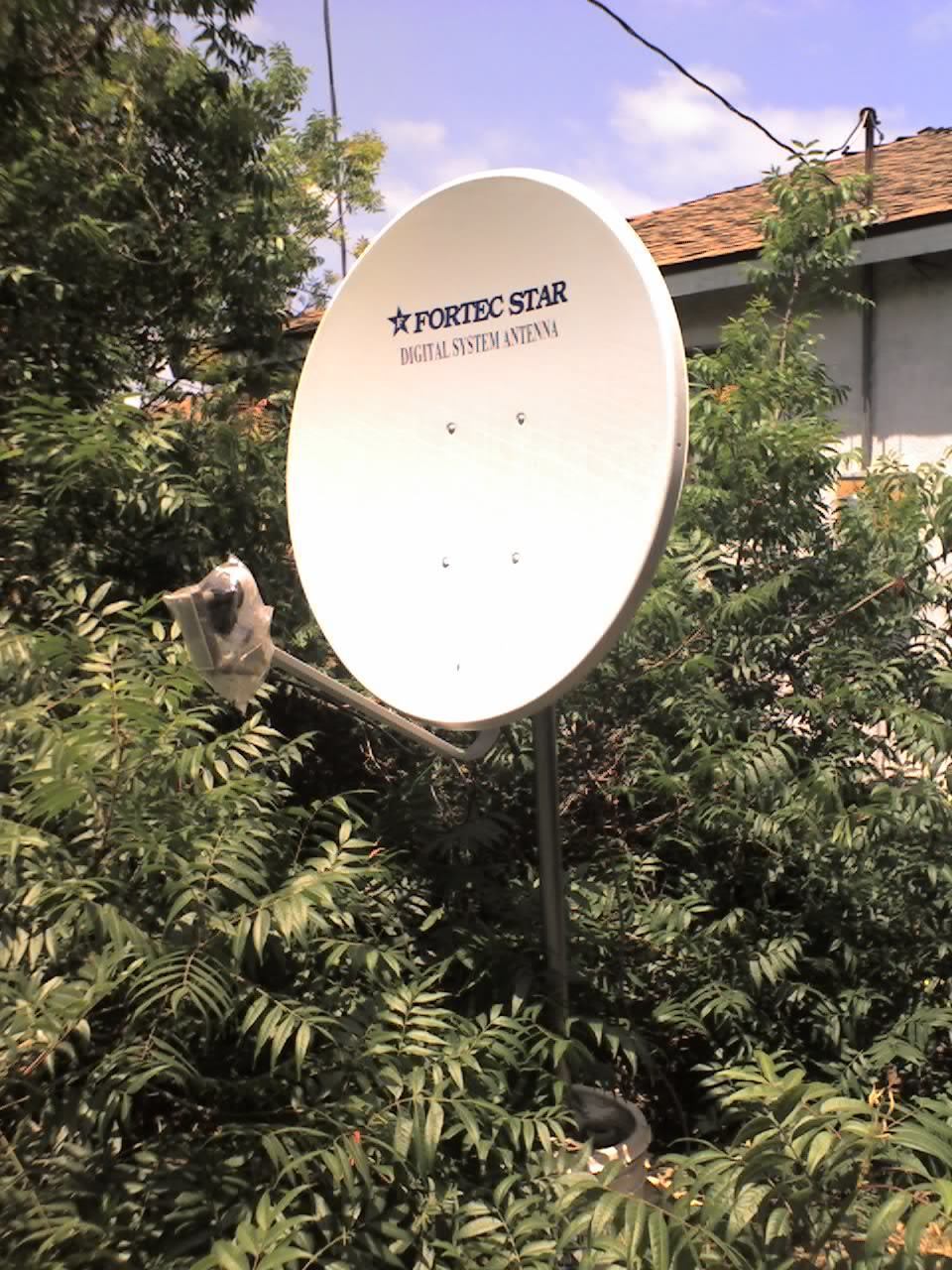

Here's an inspirational picture of a 36" dish in a 5 gallon bucket.
The bucket is just visible at the bottom of the shot.
That's a zip-loc bag over the LNB (don't ask)
The pole is half a length of a standard fence post of appropriate size to match the dish mount (same size as the J-pipe mount that came with the dish).
So, that makes it roughly 5' of pipe with a dish on top.
Talk about being handy to get to! Just the right height. - :up
use of machete is optional - :eek:
