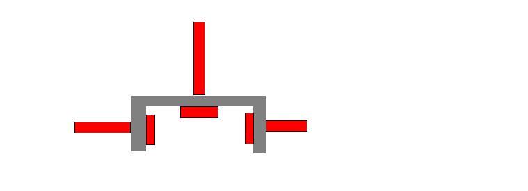

I'll be the first to admit that I'm not a resident professional with C-Band equipment; but I would like to think that I'm fairly decent with fabrication and repair of various mechanical components.
I was studying that day time picture (that video is private and not viewable to non-friends), and I came up with something that might work for you.
I am inclined to believe that if you had a 1" wide strip of plate steel, you could easily bend it into a "U" shape to replace the threaded T-rod bolt.
I hope this helps.

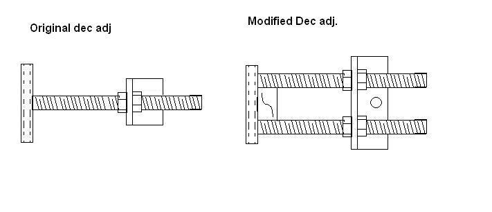

the winds around here will do it easily also. Especially winter/ spring. That's probably why, if it happened to me, I'd figure out some way to "BEEF IT UP". Just a(nother) thought, instead of just one bolt between the tubing/dish mount, I'd opt for 2.

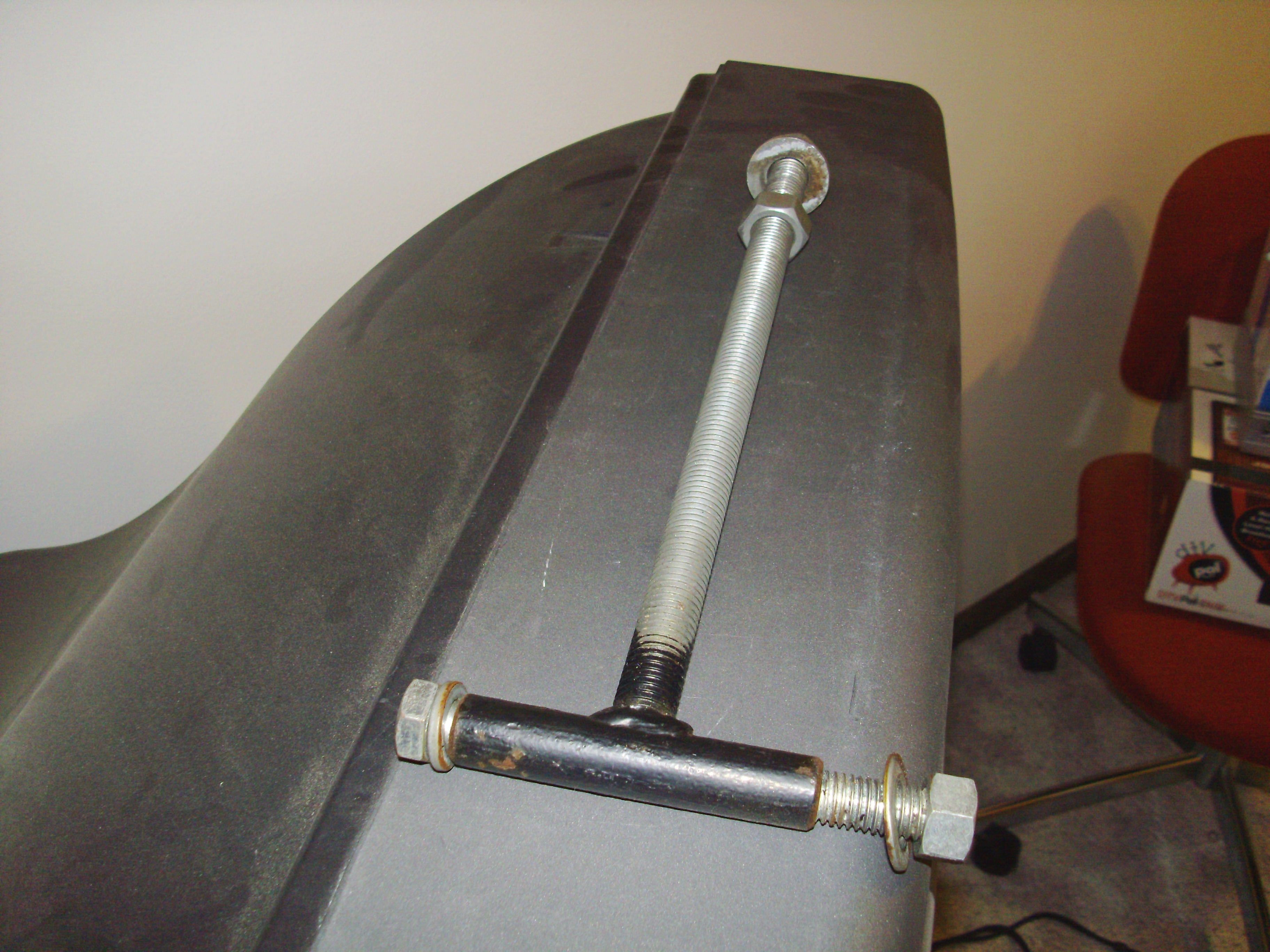

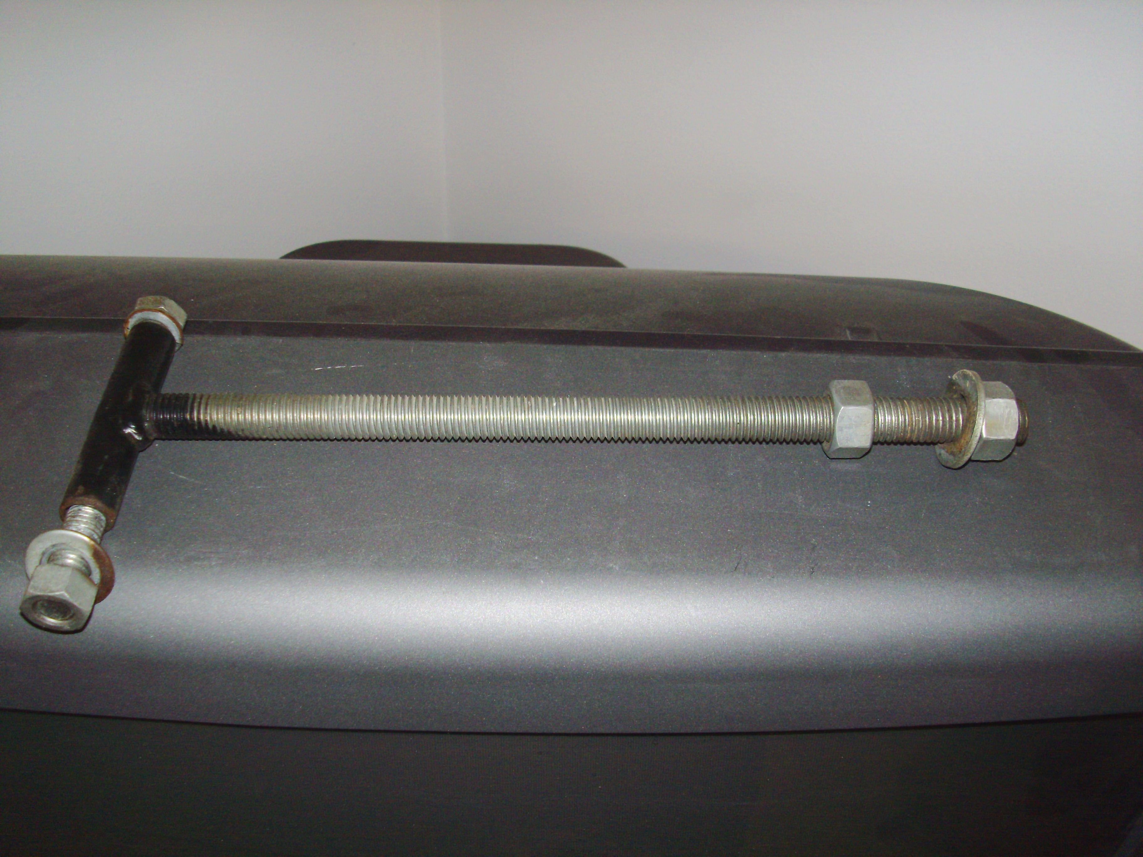

I was cleaning out the garage and I found the elevation bolt from an old 5 footer I had...dont know if that would work or not
some pics (the rod is about a foot long)
