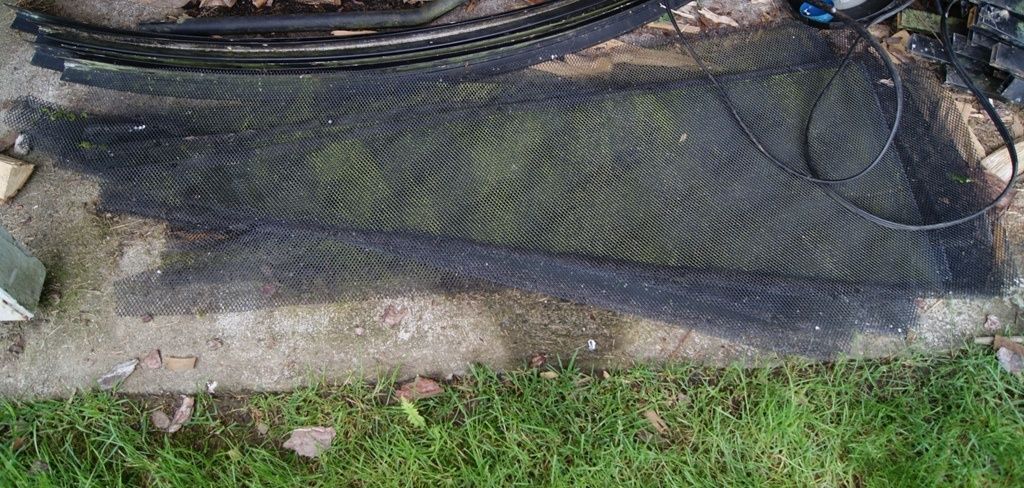

About the sensor. it has to be a reed switch, not a 10 turn potentiometer. Some pictures of the inerds? 4 screws to remove the back cover. Heck, pictures of everything. One of the mesh, close up, with a reference (dime or a ruler) If the holes are too big, Ku band might not perform very well. (So a C band only LNBF)

Eventually I'd like to see if Ku band is a possibility (the mesh would have to be replaced? modified?), does anybody sell replacement mesh (cut it yourself to fit?)
if your parts are good there good. if ripped or missing a donor dish might be easier or add a picture of what need a member might have something. very few good ku 24/7 channels imo it best to go with a 1 - 1.2 meter dish for them so add that later...after you are Hooked

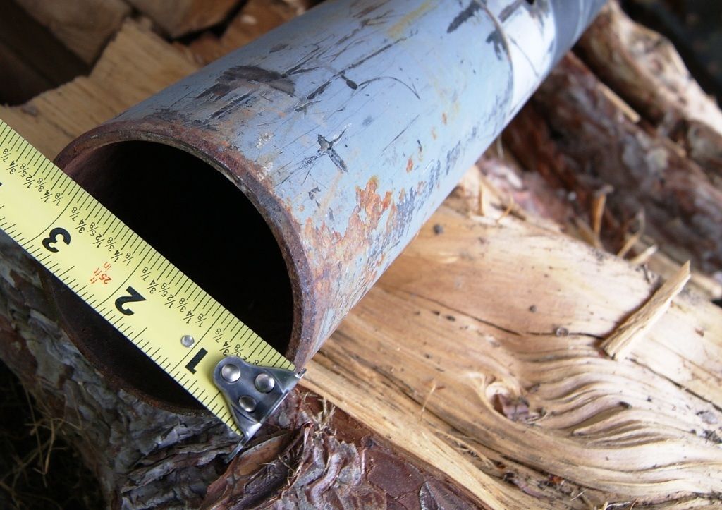

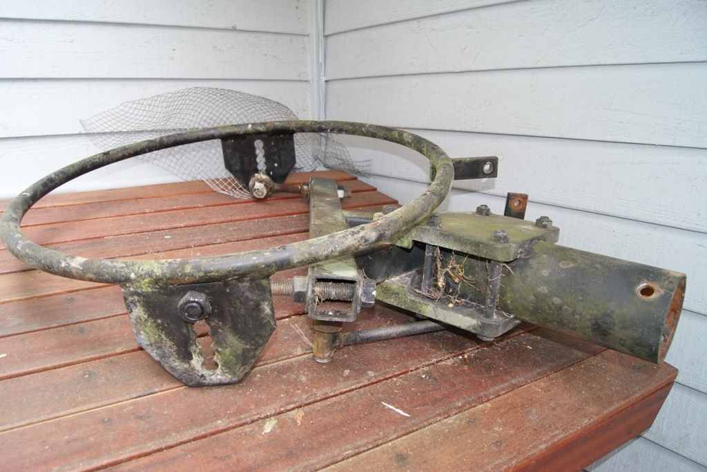

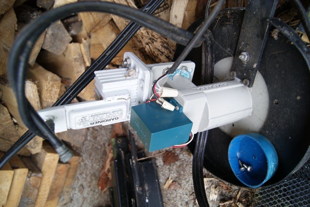

shot some pics, be warned this is ugly... the entire dish is in pieces as I disassembled it. The mounting post is 3.5" x 14 feet steel (100+ lbs), you can see the rotator ring and other pieces. Everything you see needs replacement or lots of work.

Here is my opinion on paints:
http://www.satelliteguys.us/threads/166575-AMCI-perf-on-AJAK-motor?p=1764717#post1764717
Basically, get off any loose rust with a (motorized) wire wheel
Spray on two coats of anti-rust primer.
Apply top coat of choice. Preferably another rust-inhibitor.
That's for steel mounts, motors, 'n poles.
For aluminum parts or mesh/perf/solid dishes, we need a larger conversation.
That's why we need pictures.
Don't want you painting the actual dish if it's not necessary.
PS: not a big fan of flat black. (nor white)
But a good charcoal gray can disappear into the skyline. ;)
I'll add one more comment. If you do decide to go with a C/Ku LNBF make sure you get the "standard" version not the universal one as the universal has some funky Ku LO settings and your TP numbers will likely be off from what the "normal" numbers would be. I made that mistake on my first purchase and now I only use that universal one for testing when something has gone wrong with one of my systems. From what I've seen, the universal ones are designed to be used in Europe, not the USA.
do not buy a C/Ku LNBF these are bad and are getting worse.
the feedhorn you have should work fine for C/Ku if the lnb's are good. you would need a Pansat 9500 receiver to control the servo motor(blue thing)
