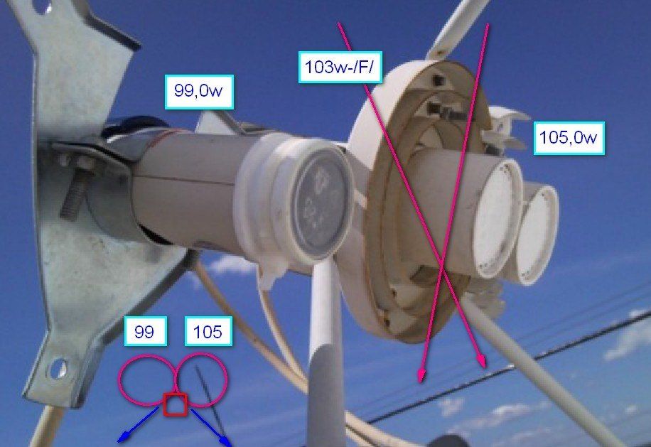

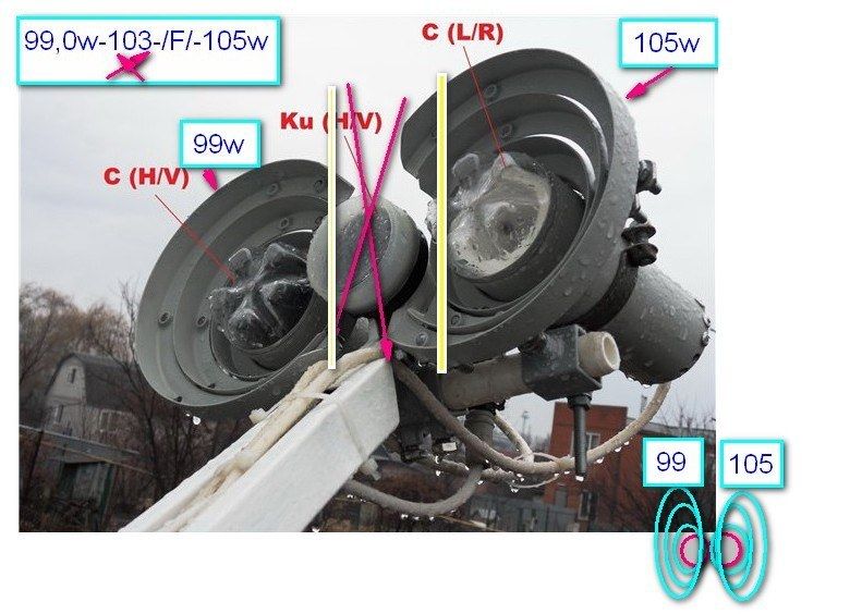

99w----105w
=carlosbrolotobar = the Variant 99w-103w-/F/-105w at you will not go.
On your country the beam-with-range shines only.
If I lived in your country, I would establish so-as on a photo more low.
To adjust Focus on 103w.?????? it is constant Dish.?????-\take off\- LNB on 103w.
Then to take LNB on-with - with small diameter of an irradiator and to adjust lateral companions on 99w and 105w.???????-strengthen- very densely and to fix.
If LNB-?-on 99w and 105w will be with an irradiator to cut it is necessary on the one hand and to press densely.
And on the companion 103w it is necessary still separate to Dish th 0,9-1,2m

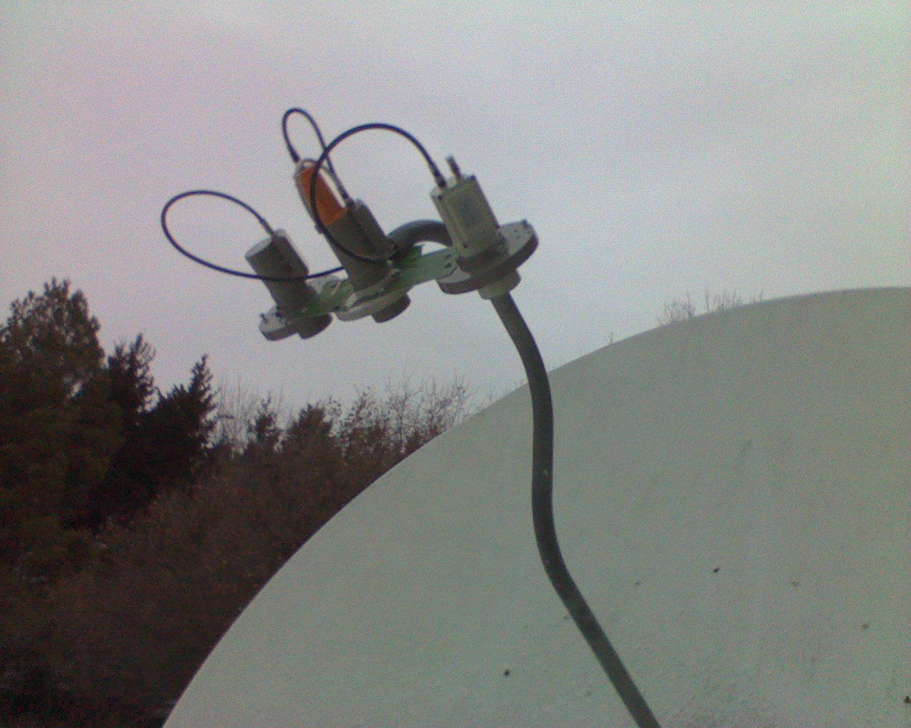

This is on a 2.4m dish. Center LNBF is on 99W. The one on the left is on 91W, and the one on the right is on 107W. Just to give you an idea how close the feed horns need to be. This is a fairly shallow dish with a longer focal length than many. It's a solid spun aluminum dish.
There is a small chance that 2 of those lnbs may be combined into 1. it has happened by accident by me for 99 and 101. If you do that, you will lose a lot of Q , but i suppose it depends on what TP's you wish to catch.
I have done 40.5 and 43 on a 10'dish ok, but it is the closest i could do.
I mean , try 1 thing, try them all, what the heck!! Great fun.

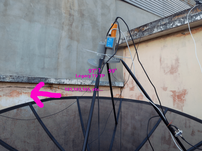

Something weird happened yesterday....
I moved the antenna searching 103°, so I had to move my principal LNB to catch again 99°.
So next to it I placed the other LNB... I was moving it up, down, forward, etc... to see if I catched something when I suddently catched 97° .... Legacy TV transponder was strong 45% signal there.....
I was specting to catch > 99 not <
Funny thing.... I will continue testing...
Can certainly tell from your picture how close you are to the equator! I take it you modified the scaler ring(s) to get them that close?
