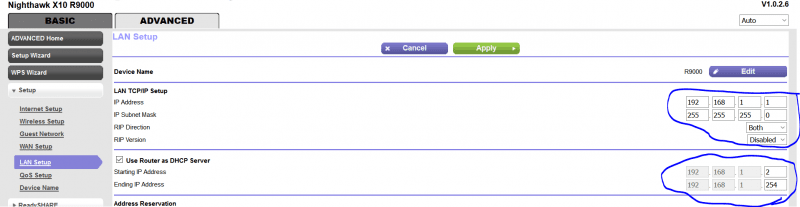

I ordered the NETGEAR Wireless Router (WNR1000-100NAS (G54/N150)) from Amazon to be delivered on Thursday. I will then disable the 2.4Ghz radio on the Linksys WAC1900 and then connect the Netgear to an open port on the Net Gear 24 port Switch. Then, hopefully it configures a good wifi signal to my bathroom where I have the Qardio scales and the next room over where my Laser Printer is located. If I get those two devices working the other stuff can remain on the 5Ghz from the Linksys which has excellent coverage throughout the house and back yard. Since I will essentially have two routers working, I should probably exclude the two IP addresses on the Netgear from assigning on the Linksys.
I would set the new netgear up as 192.168.10.1 so that the DHCP pool starts with 192.168.10.2 up to 192.168.10.254.
Assuming your current Linksys is set to 192.168.1.1 and DHCP pools has 192.168.1.2 up to 192.168.1.254 ...
If you leave the netgear alone, it'll be the same as the linksys most likely, and you might have conflicting IP addresses.
All you gotta do is change the netgear from DHCP to static ..see the following.

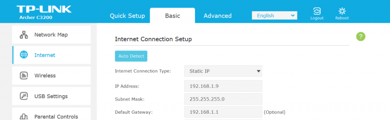

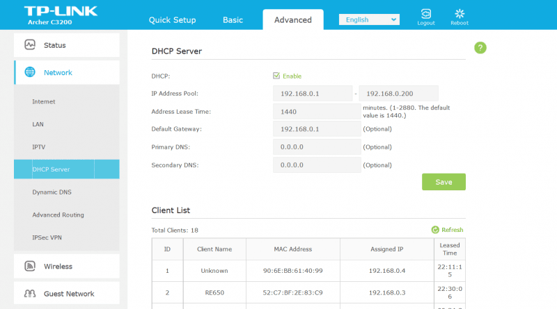

This is a TPLINK that's connected to my 192.168.1.1 netgear...and I chose 1.9 for the IP address, while using 0.1 as the DHCP pool for this router. Your netgear should be similar to this:
In Netgear, the DHCP and IP selection screen for your new router should look like this...same as mine.. except you want to change from 192.168.1.1 to 192.168.10.1. Would probably just be easier to do that than to do it another way -- which is possible also.. Just my recommendation if you want to rule out any future conflicts that may arise:
