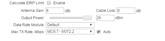

This screen shot is from my outdoor wifi. It's a ubiquity bullet m2 titanium. It is fully adjustable also and outputs 600 mW of power.
Edit: At 26 dBm it's 398 mW, at 28 dBm which is max would be 630 mW.
