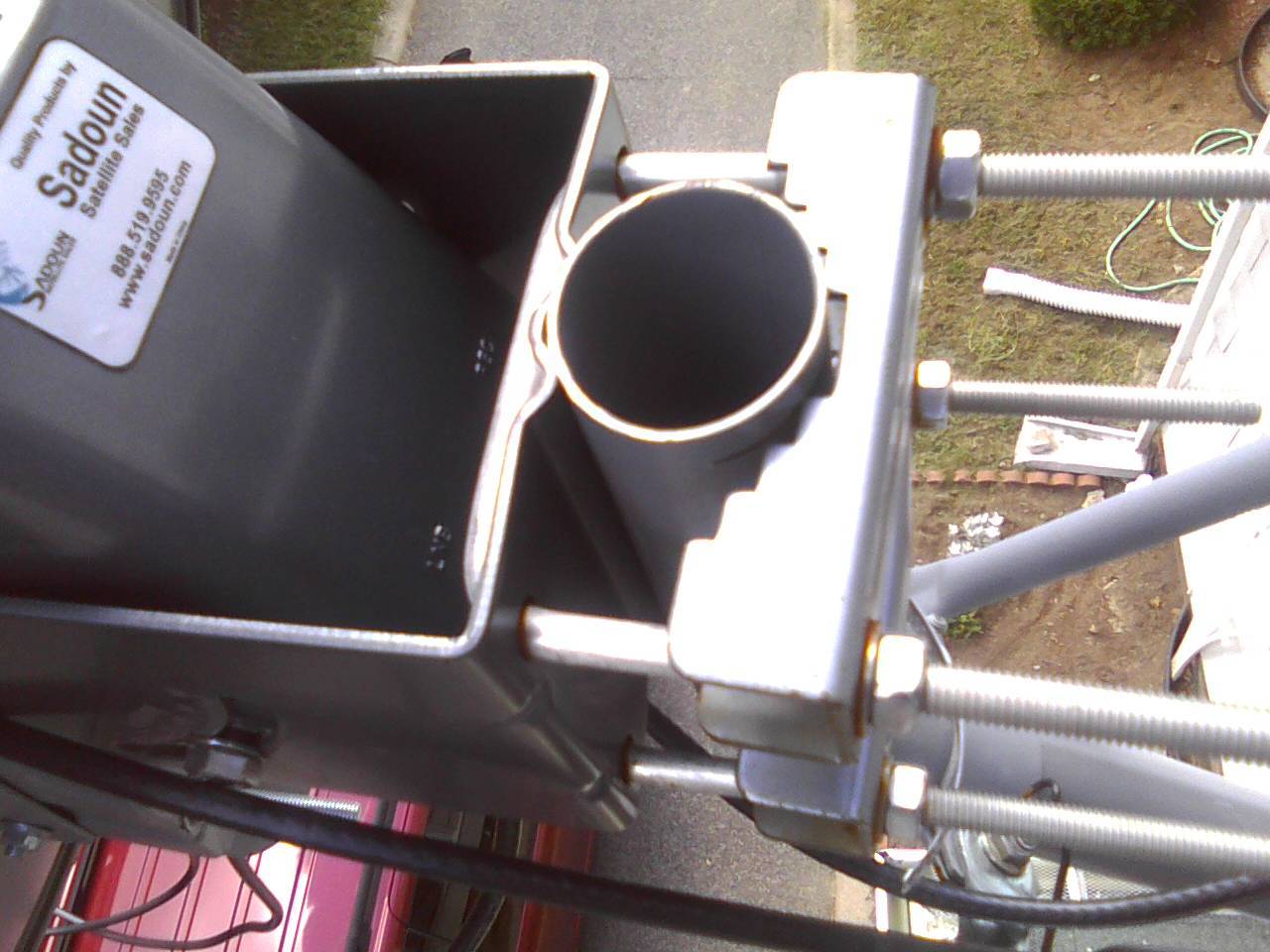

Need A Thick and Strong J pole.

A concrete solution.
I don't know where you can get a heavy wall J-tube, but if you fill a standard tube with concrete and let it harden for at least a week before stressing it, it should be uncrushable.
Any muffler shop will bend a heavier wall tube to meet your requirements.
If needed, insert a smaller OD pipe or other round object to prevent the mast from collapse.
Brian, That is a good tip and while you are going, take the OLD j pole and the shop can make the insert (s) to fix the old one. If it is a neighborhood shop and not busy, it might just cost a couple of bucks! You might want to do both ends!
I had the same thing happen when trying to mount my rotor. Found a chunk of scrap heavy conduit in the yard but instead of bending it, I cut and welded it.
Allow me to recommend the J-pole/monopole system used by D* on their Slimline dish. This mount is excellent for a motorized dish, as it allows leveling in all directions, and is extremely sturdy. The J-pole has very thick walls as well...
Thanks guys for all your suggestions. I will give an update .
You can go to Home depot and see if you can use plain old iron water pipe with a couple of 45's to make a J shape. I use a straight piece of water pipe in a tripod and it works You would break the bracket before you crush the pipe.
