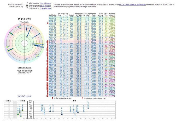

I read a lot about antennas and converter boxes...I live in 30157, 39 miles away from towers... i would prefer the antenna to be an outdoor one but if I could install it in the attick would be better...also on the cheaper side. Will need to have an amplifier too...But I'm just a girl, what do I know about devices......Please, if somebody has an answer to my question...Thanks in advance!!!!!!

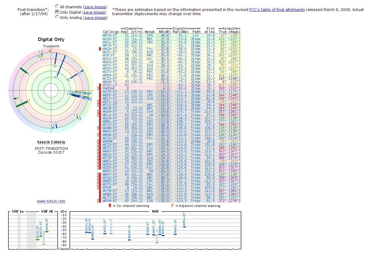

Well, the setup you choose may be determined by what all you want to try to get vs what you must get. Take a look at your post-transition chart. At least 2 area channels are at a heading at a very "differing direction" than most of the others and 1 of your area PBS channels will be VHF-Hi. I would concentrate of those channels at 50 miles or less.

Thank you, but i don't quite understand what you mean...I don't have technical knowledge at all and I would really apreciate it if you tell me the exact antenna types that may work..We have 1 digital toshiba big screen TV and 1 Sanyo analog small TV if this might help. I read about the converter boxes and I think the CM 7000 is the best choice...but the antenna choice is my problem...Thanks again
You need a VHF/UHF antenna to receive all the Atlanta stations after 2/17/09. You will need a compass heading around 100 degrees and about 30 miles from the broadcast towers. A Winegard GS2200 or a Winegard HD1080 should work but you need to make the choice for your own satisfaction and circumstances.

You may be lucky enough to receive the LA VHF channels due to the LOS advantage of your location. I doubt iamsimona will get reliable reception on channels 7 & 8 with 1 edge diffraction and signal strengths around -70 dbm. He'll probably need a yagi antenna with higher VHF gain for those channels.

Line of sight we do not have and I'm not quite sure what edge diffraction means but TVFool says I have 2 edge plus they say post transition I really need a 300 foot antenna mast. But somehow I get what I consider really good results with my C4 25 feet from ground level.

You must have some huge terrain variations in your area. Just plugging your city name into TV FOOL shows 26 LOS stations; even at ground level. If your signal levels are -40 or so; you may still be in luck.
