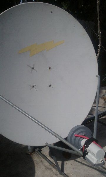

RimaNTSS MACHO where you buy you lnb holder for you dish ,today i get one free like your from the hotel i work in miami, i want to try it man i saving right now to get one 12ft from tek2000 and pay a guy to do the installation, is almost 2000 dolares get the system, all i have for now is the c band lnb and the dish from the hotel,please help/ me man.

i get today this dish
Look on the back of the dish and see what model it is.
We can help you find one.
Even without looking at the back of the dish I can say it is Channel Master 1.2m (or 1m). In this case, size does not matter, all CM have same LNB holder. Good antenna! Congratulations TS!
Reactions: Trust
And the bad news is there is not a LNBF bracket designed for that dish to accommodate the C-Band LNBF. The support arms are too close together to hold the C-Band LNBF at the correct position/alignment. You will need to make/modify a bracket for yourself to hold the C-Band LNBF and move the support arms further apart. And lots of trial and error to get it tuned for the best reception. The dish is too small for reliable C-Band reception. You will only pick up the strongest/ highest power transponders. There are many people doing "mini-buds" like that. There are many posts and pictures of innovative ways people have attached the C-Band LNBF.

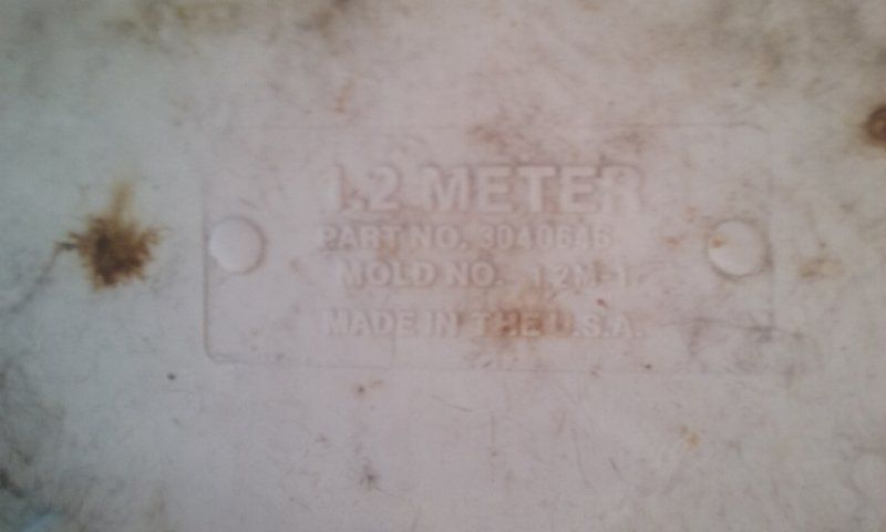

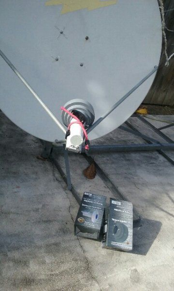

RimaNTSS HELP ME PLEASE the dish is almost like you dish man here is the picture and you get you dish running
sorry here is the picture
Reactions: RimaNTSS

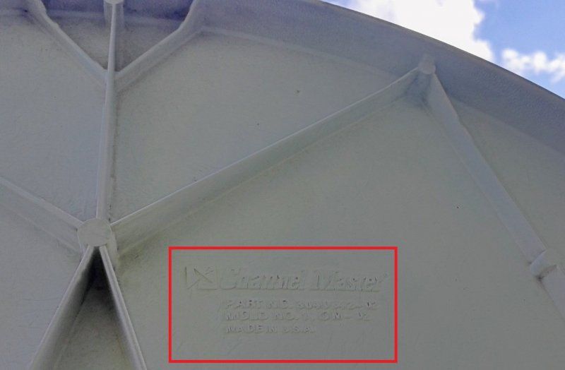

The brackets are different sizes. I know because the brackets I ordered from you for a 1.2m do not fit a 1.0m. Unless Im doing something wrong.

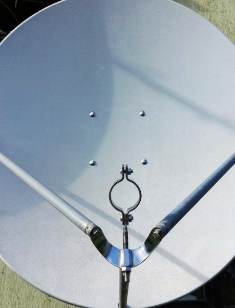

hank123 What kind of 1m dish you have? If it same as on the attached pictures than it's holder exactly the same as from 1.2m Channel Master. Unless you have VSAT 1m antenna, than it may have different feedarms and LNB-holder. Could you show some pictures please?
