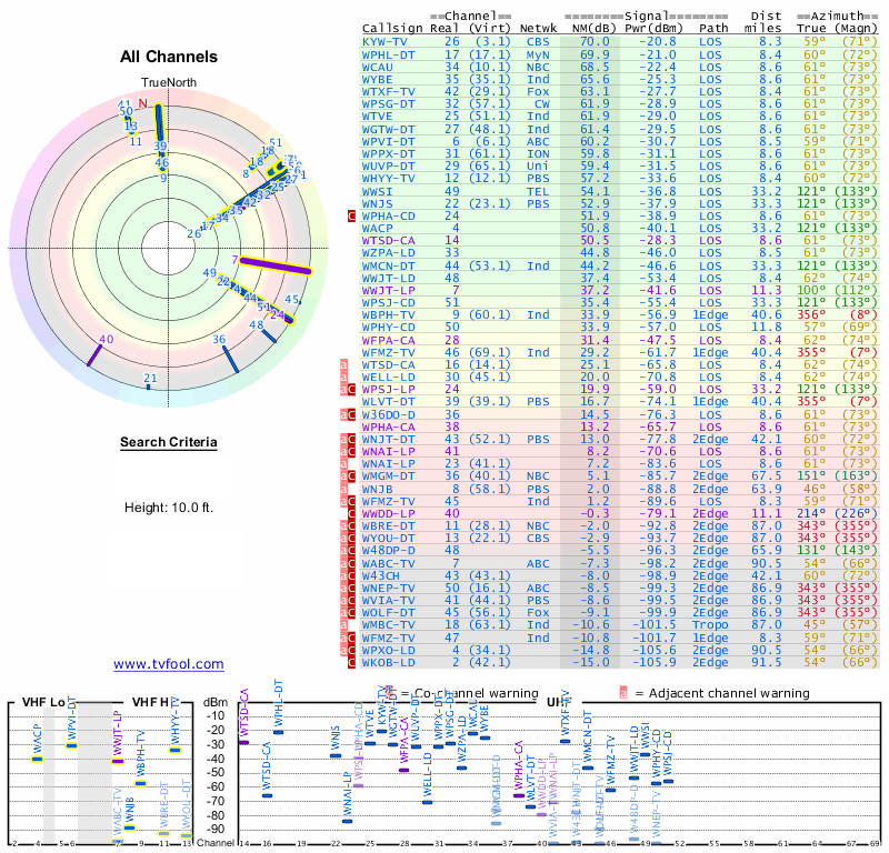

It would be very helpful if you posted the TVFools report then we all could see exactly what channels you are trying to receive and the estimated signal levels. Calculate as an indoor antenna or with elevation setting at 10 feet.
I am looking for these channels: 3.1, 6.1, 10.1, 12.1, 17.1, 29.1, 57.1
Just to review I am looking for a small antenna to place in my attic which will have a quad shield coaxial cable going to my basement where there will be a splitter that takes it to the first floor to two different TVs. I will see how the signal is before purchasing a distribution amplifier. I would like the smallest antenna reasonably possible due to other projects going on in the attic that will require room.
Here is the TV-Fools Report:
I'm positive that the antenna recommended by primestar31 in post # 51 will work just fine. (HD-1080)
Virtual channels numbers are not important, it's the REAL channel that they are on that's important. You only have one in VHF Low(6), but its only 8 miles away.
Virtual 3.1 is actuallly on UHF 26
Virtual REAL Heading Distance
3.1 26 71 8.3
6.1 6 71 8.5
10.1 34 73 8.6
12.1 12 72 8.4
17.1 17 72 8.4
29.1 42 73 8.4
57.1 32 73 8.6
