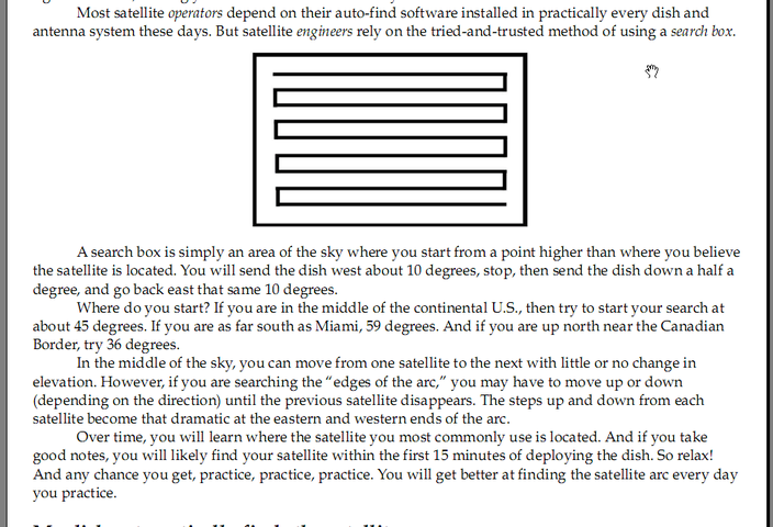

Jack, It takes accurate alignment to point at Elevation: 38.5°, Azimuth (magn.): 201.4°.
When you use a compass and inclinometer to point there, that's a starting point. To lock on a Ku band FSS satellite of ones choosing without a bit of trial and error would be quite lucky.
Once you set your location Lat and Long in the receiver and set the receiver to your satellite near true south, the receiver will move the motor to a location. Then, you can adjust the dish elevation and motor mount azimuth adjustments by hand. Once you receive the true south satellite and peak it so it comes in best, the rest of the satellites should come in by using the motor.
Anyway, you might try using the attached search box method to make the aim more accurate.

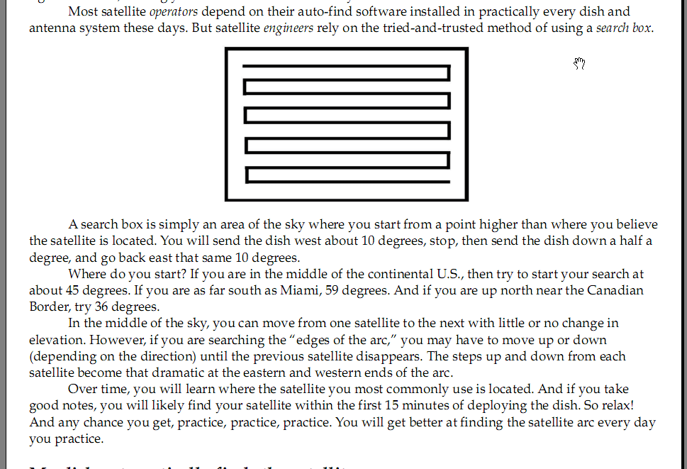

GuapoHarry,
That is a perfect visual for the technique that I have tried to describe to others for a long time. I call it "pan and scan" because the phrase sounds rememberable, but I haven't had a really good visual tool to help explain it. Your input here is just perfect to paint a mental picture of what we are trying to tell others to do. It is a methodical process of scanning a specified field of the sky or a window of the horizon to search out a signal that you believe to be contained within those boundaries.
