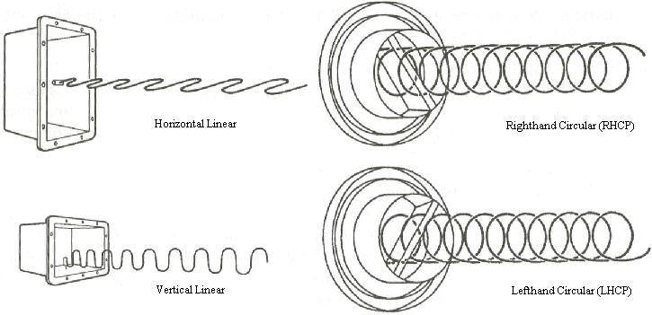

What is the difference between linear and circular signal? Is it better to have an lnb that do both?

I've attached a pic that shows the difference between circ & lin signals.
Most of the FTA sats that are viewable from your location (Quebec) only use linear, the DBS (Dish, DirecTv, etc.) sats typically use circular. So, for true FTA viewing, a linear LNBF will get most of what's up there.

I am afraid that I do not understand very good here. Galaxy 25, 19 and so on are linear, Bell expressvu and others are circular? How do I know wich one is wich?

I am afraid that I do not understand very good here....How do I know which one is which?
A Rule of Thumb: EchoStar, DirecTV, and Nimiq Sats are Circular, the rest are Linear.
Go to:
North & South America - LyngSat
Click on a Sat, the look at the first column: "Freq TP" if you see:
"H"orizontal or "V"ertical is Linear
"L"eft or "R"ight is Circular
