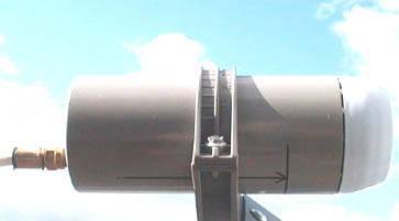

Does it look like a "flashlight"? (one giant LNB...usually had one output)..1st 2 pics

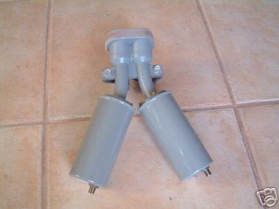

Does it look like the "beer can" ones (had 2 outputs and required a switch)...3rd pic

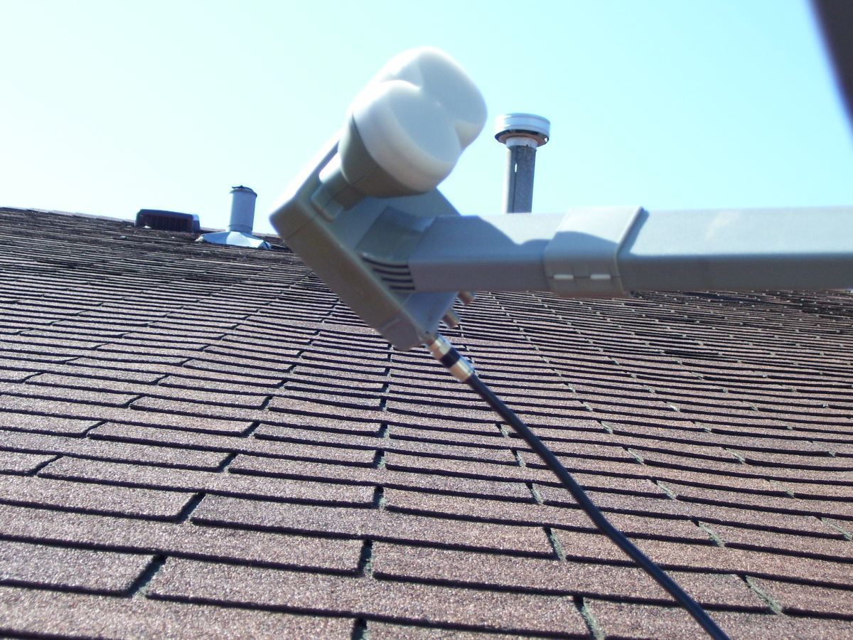

Or is it the newer quad with 4 outputs?...4th pic

Success, finally, managed to finally pull in galaxy 19, the answer to your question Iceberg is the photo 2nd from the left. It seems it is a linear lnb. I apologize for being in the wrong sub forum also. This very cool, being on this site, you guys are great, and I appreciate the help, obviously there is alot of reading here to do. At the moment, I am watching Chinese tv, some in english , french, etc. I gather that some of the stations are broadcasting at different times of the day, so lyngsat has all the particulars, or is there another site available, to make it somewhat user freindly. There are 2 bud, nextr door not in use here in the country, and I think the boys will part with them, so first , to get a motor for my dish, any recomendations on that fellows, I saw your rig set up Iceberg, most impressive, so in all reallity you could pull in more birds with 4 lnbs on the same dish with spitters, very cool, I hate asking you guys what c-band receiver to use and motor, obviously I have to read here first as to not put mouth into foot, when it has been posted in the past here. I'm getting the jist of this, and again fellows, thanks alot, fab site, glad to be a member. looking forward to some great reading, and following and hopefully contribute in kind.
