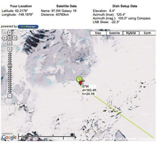

Thanks alot for all of your expertises. I'm thinking about getting a 4 foot dish, but where I live there is a large mountain stands aproximately 25 miles away from my house. I wonder if it is worth getting the 4 foot dish. Also, a foot dish will get c or ku band? I already got a linear lnb, but with a 4 foot dish, what lnb should I need? Thanks alot.
I live at Hatcher Pass in Palmer.
Hi TOOJ
:welcome to the site.
It seems your LOS is blocked by the mountains to the East of your location. The dish elevation is very low and I am afraid it won't work.

Again, thanks alot for helping out. I finally spot a 6 foot dish for sale. The guy told me it works with dish services althought the mountain is blocking the dish. I wonder if the 6 foot dish will work with 97 w. Thanks alot for your expertise.
Unfortunately, this person is not correct. No matter what size of dish is used, satellite signals will not pass through mountains, trees, buildings, etc.
You will receive 97W if you have a 1M dish or larger and a clear line of sight to the satellite.
