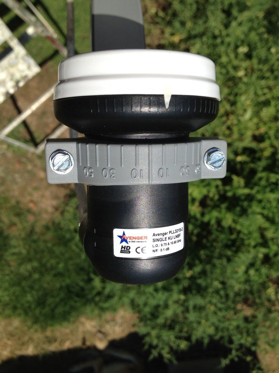

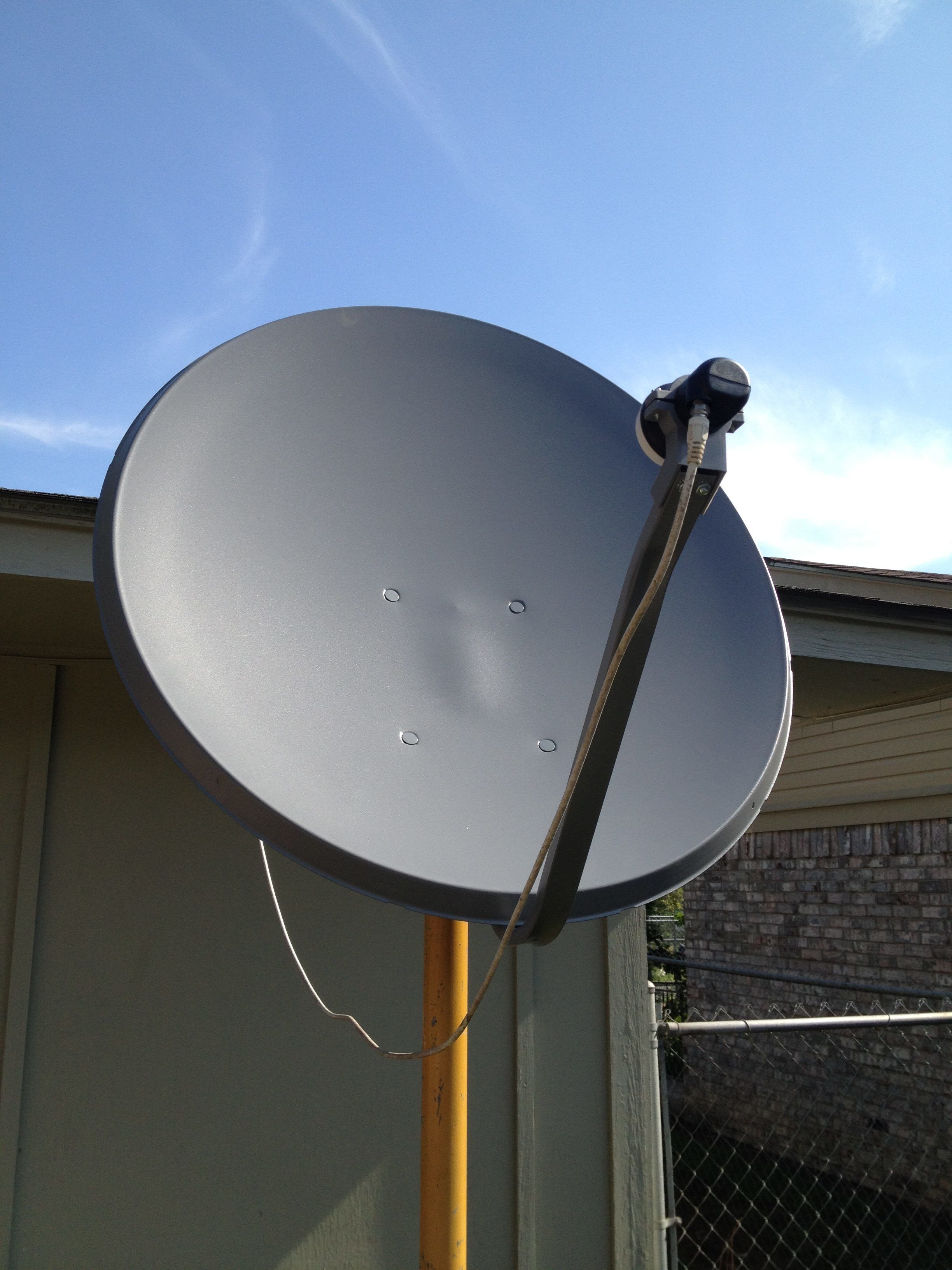

thanks for the quick responses! Below are a couple pictures I hope will help us out. Also, my dad informed me that the middle of the dish
was slightly damaged due to my sister's boyfriend trying to help install it yesterday (he accidentally tightened something down wrong?). There
was a bit of teamwork going on between me on the phone, and my sister and her boyfriend acting as my hands while trying to teach my dad
everything we're learning on the fly ;)
Satellite dish is stationary (no trees or buildings blocking)
LNBF = universal = 9750/10600
I had my sister configure receiver with the TP settings stated on Lyngsat.com:
1. Receiver setup via microHD GEOSAT manual via: http://www.satelliteav.com/portal/33/images/microHDmanual.pdf
2. 11780 (I don't recall which letter was after this number on the GEOSAT microHD)
3. 20760 - 3/4 (although it might be set on 20761 b/c my sister's boyfriend said he found on the web that this is where CCTV-4 is?)
My dad had question regarding his old LNBF:
1. Does the LNB become weaker over time and need to be replaced or reset?
Thank you for the patience and effort to help us with this. Results may take a longer than expected because it is like explaining to a grandparent
how to navigate high tech equipment with the added complication of translating the instructions in broken Chinese!! :eek:
damage is not good . sometimes areas where damage happens doesn't affect signal much. but this damage is in the center . it should be possible to fix damage area by removing the dish from the mount and using a rubber mallet lightly hitting the damaged area or you can try to lightly press damaged area hopefully popping the dent back out.
also if he was receiving signal with damaged dish ( middle eastern type channels ) he might still be able to get CCTV with the slight adjustment listed in my previous post.
from the picture of lnb -- the white arrow needs to point close to the 0 on the left side ( its on the right side now pointing at -10) its very small increments
although lnb's do fail , I don't think its very often.

I'm a newbie, too. Welcome! The guys here are, in my opinion, the best online to help you figure out how to set up your FTA system. Sometimes a strong wind from a storm can slightly move the dish...but that's enough to point it towards a different satellite! In layman's terms, as several other people have suggested here, if your dad is getting middle east channels, it's pointing at the wrong satellite (97W). If he can bump it ever so slightly to the east, (try moving 1/8 of an inch at a time) he should pick up the CCTV channels (95W). That's probably all he'll have to do. I agree with the other folks that would be good to get that dent out of the center of the dish for best results. :D
I agree with Gabshere... That damage needs to be straightened out first. You will also want to do a 'string test', which involves running string across the dish from top to bottom and side to side. The two strings should touch. If not, the dish is warped. The Winegard will bend and warp easily, and it is imperative that the shape is correct or else the LNBF will not see all of the signal.
I don't see it being mentioned but I'd also check to make sure the pole is still level after you repair the dish.

My dad says he fixed the dish with a rubber mallet. My sister was able to confirm that she could still get a fair amount of international channels as before.
They DID try to move the dish ever so slightly towards the east (tiny increments at a time) from the position where they were receiving the international
channels and that attempt was still unsuccessful.
