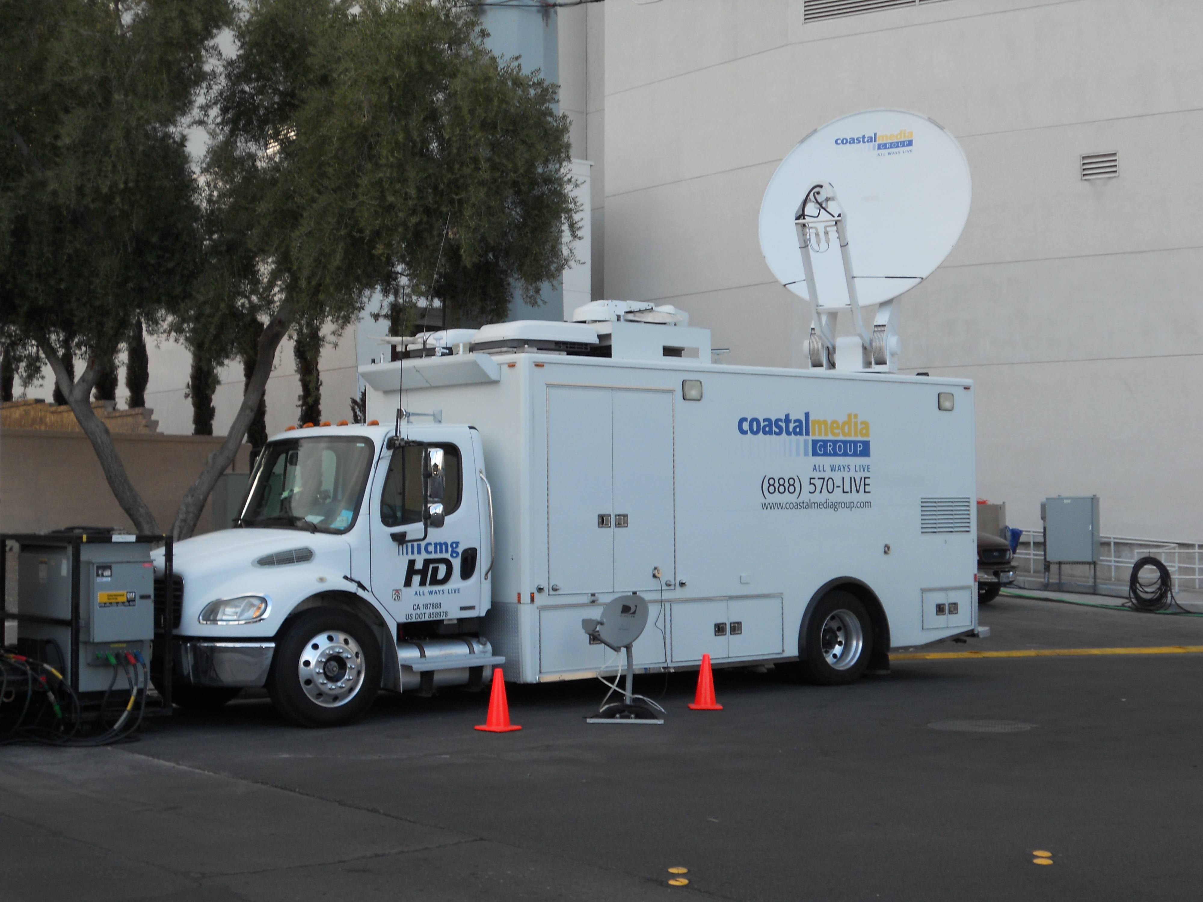

With this DSCN0457.JPG I don't seem to have any issues with polarity. :D:D:D
kingofku,
Nice rig...is that a Geosat add on ?? :D
