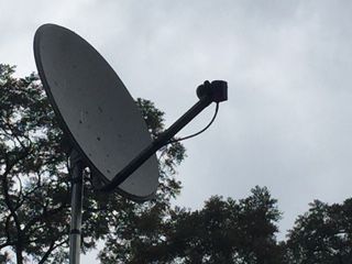

More importantly at the moment is that my Pennsylvania set up just changed. I have one dish, not a shaw dish. It is a regular type dish about 30" wide and 35" high. I put in a new LNB in April due to their changes but I think it is only for non HD. (?) Unless I need to tune the dish in better. (?)
Thanks for the pic and I reread your first post. So yes it looks like you have a single satellite setup and probably aimed at F1R. Which means you would have lost many channels this past week. If you are in extreme northern PA you might be able to use a shaw 75 cm dish. That might be your best solution for your PA setup. There are some satellite dealers and ebay that would be a source of that equipment.

I bought the new 75 cm dish and triple LNB. Hooked it up as mentioned by others here. It looks exactly like the same positioning as my old round dish but I cannot get a signal. On the receiver I get signal strength as high as 65 but when I hit for "A" on the remote for a channel I get ZERO. I called Shaw but of course they were no help since I am in the US.
I am assuming that you have the 75e set up correctly as far as skew and elevation for your location.
If so, then by your statement above, "It looks exactly like the same positioning as my old round dish but I cannot get a signal." do you mean that the LNB arm of the new dish is pointed to the same place in the sky as the old LNB arm?
If the answer is yes, then that is where your problem is. An elliptical dish when skewed correctly (in your case the left hand side of the dish is higher that the right side, when looking from behind the dish) needs to be pointed differently than a round dish. The LNB arm should be pointed further to the left (again, looking from behind the dish) than a round dish.
So start from where your round dish is pointed and very slowly pan to the left in small increments until (hopefully!) you get a signal.
