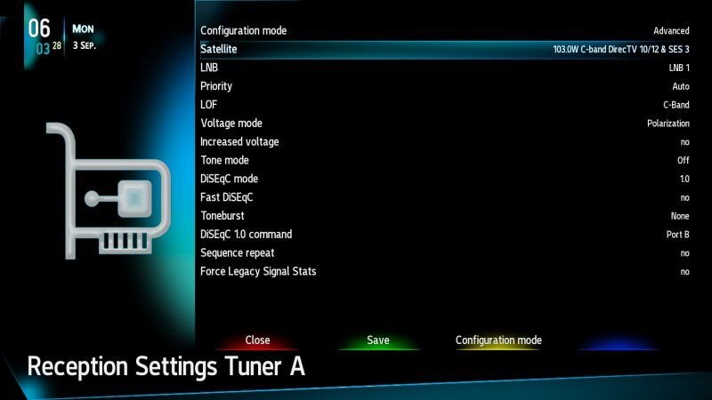

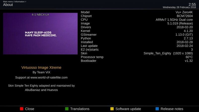

Press menu and see if you see information if so press ok on that and then About. That should have info on what image is loaded.
And to set the ant/lnb. Press menu and look for setup and system searching and Tuner configuration.
Probabably use advanced mode. Choose the Satellite then lnb number 1 or 2 ect. go down the list.
I don't know you setup so I can't tell you what to enter.
Here are some pictures of my image and LNB setup for 103w sat.
