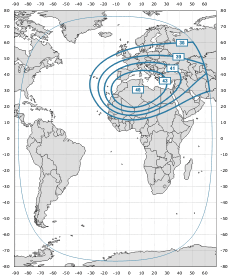

Then I was told, unfortunately, there is no footprint for KU into North America on Express A3. This satellite KU signal only covers Western Europe. The LNBF also would need to be Universal type as all KU frequencies on that satellite are below 11.7 GHz.

The Ku FTA channels on that satellite are not receivable in the U.S. The Ku signals are on transponder 12. They basically cover only northern Africa and southern Europe. To view the footprints of the various transponders of this satellite see http://www.rscc.ru/en/satellite/zones/zone09.html
Their press release says that the satellite does have coverage in eastern North America, but those transponders aren't the ones used for KU FTA signals on that satellite.

Let me try this again. The RSCC channels on the lyngsat website are C-band. A 31 inch dish won't pick them up. The KU band FTA channels, Napoli Nova, Mediteraneo Sat 2 and Mediteraneo Sat 1 are not available in North America from that satellite. You need to refer to the footprint of a particular transponder to see what area it does cover. You'll also notice that Lyngsat says that the KU band transponders cover the A9 area, not global which would cover the east part of North America. The press release you refer to is over a year old and apparently things have changed since it was issued, at least for the KU band.
