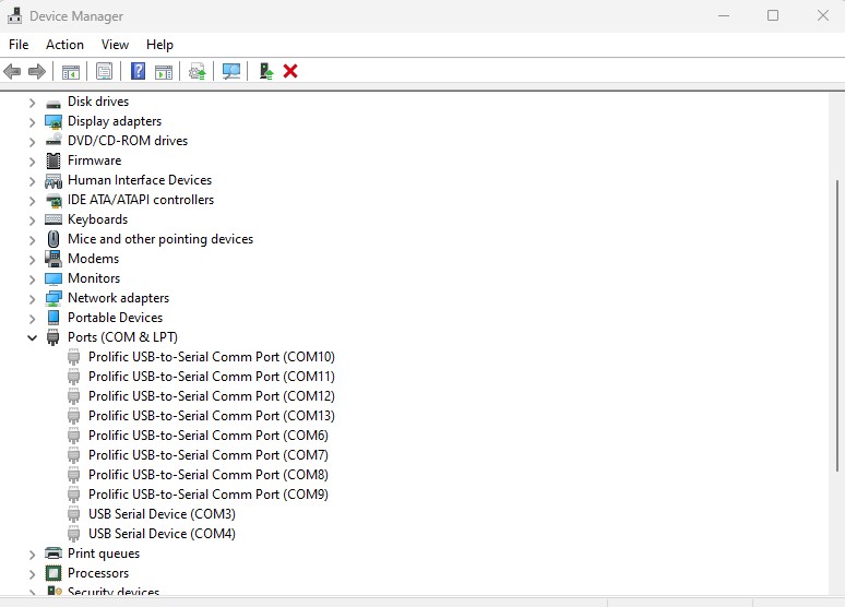

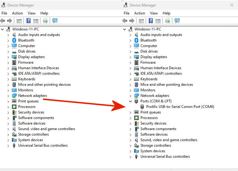

I see no com ports in the device manager until I plug in my USB to DB9 com converter cable (same as FTDI cable?) When I unplug the converter cable, the device manager shows no com ports. (see pic. )
When I physically switch USB ports with the cable converter, within the PC, the number in the device manager changes from com6 to com7, com8 ect..
When I chose "show hidden devices" in the device manager, it shows as pictured below. I can account physically for all ports. except com3 and com4.

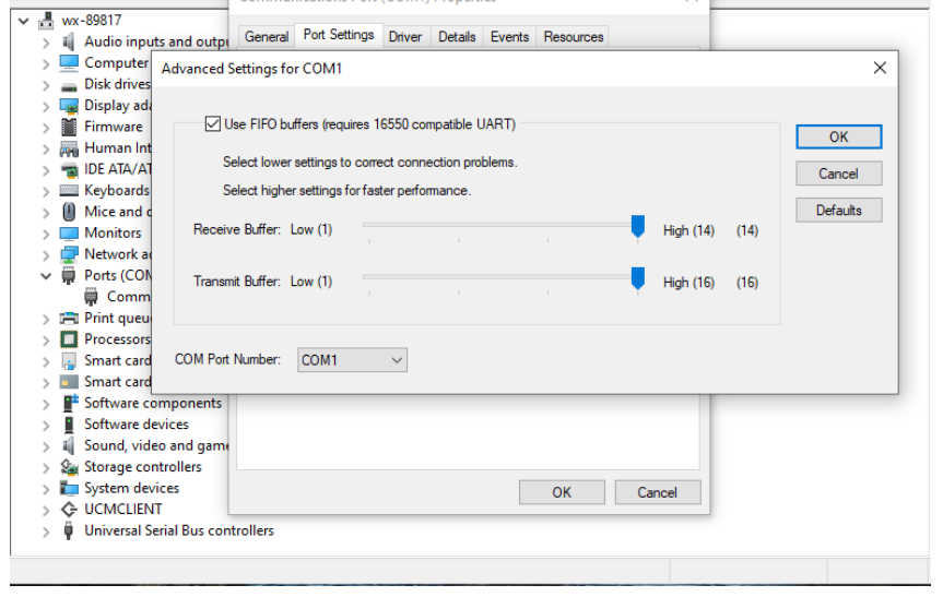

I studied your attached and Windows will let me let me assign different com port numbers but only from com16 through com20. Nothing below com16, so no com1 through com4.

Try unplugging the FTDI cable. Then while showing hidden devices, delete every com port there is.
Shut down and cold boot your pc. Don't just restart it. Then turn it back on. Let it settle down and open Dev Mgr., show hidden devices. Any com ports?
Plug in your FTDI cable. What populates? Port number? Can it be manually changed to something usable?
How about in the meter itself. In the menu can you assign a port number (You may have already axed me that)?
.....axed. lol
The Com Name Arbitrator Tool is linked below also. Some other cool tools for a rainy day.
Sorry you're having issues but for the FTDI at the very least manually assigning ports should work.
Did you check under all USB related items with show hidden devices enabled for any instances that may have in the past taken over the ports you need?
Hint. If you get a persistent....com 3, com 4...device sucking up the slot you need. Why not try bumping them up to a higher port number.
There also is a method in dev. mgr. to show non-present devices such as USB flash sticks, cameras, CF cards, external HDD's that aren't plugged in....but were at some time. Google search for it. Requires that you open a command prompt as adminintrator, copy and paste or type in a line of code. It's non-destructive 100%. If you wipe USB stuff, the next time you plug them in. They will work ok just as before. We need to get you the com ports you need.
