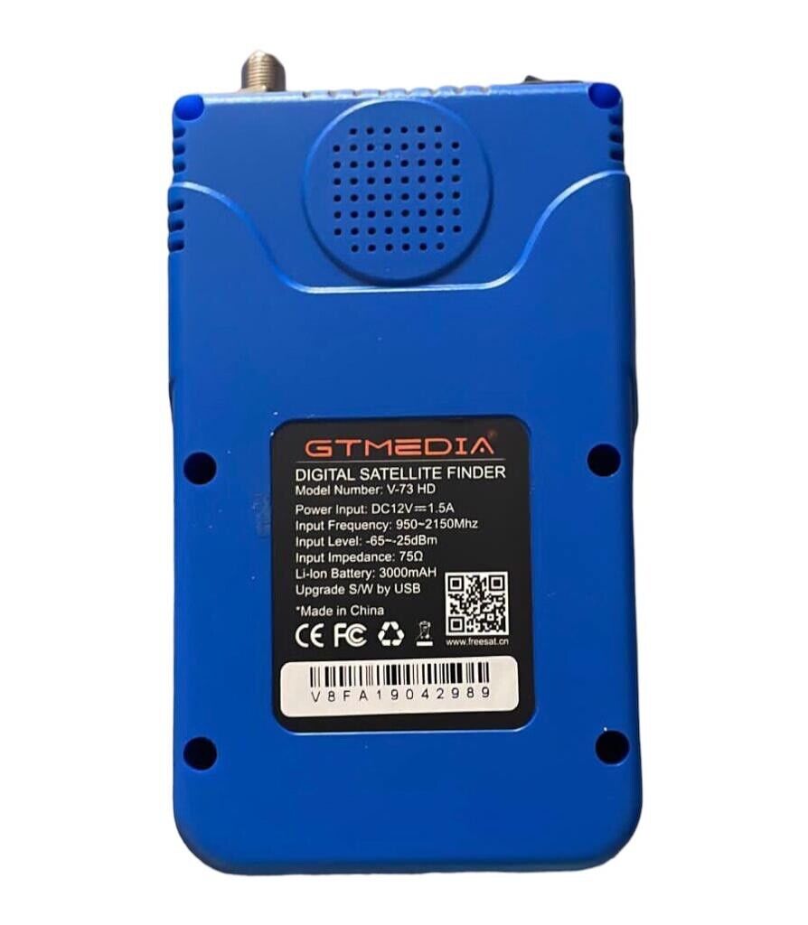

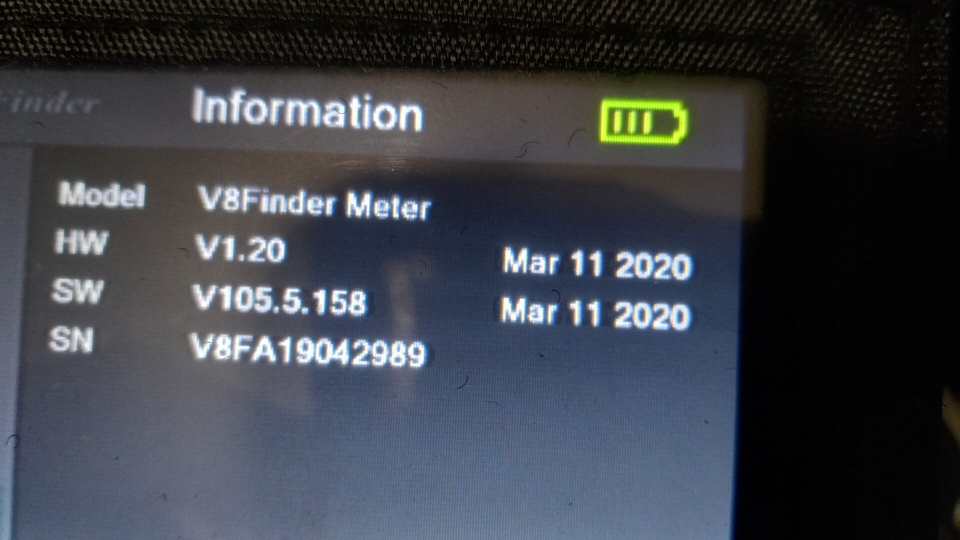

I picked up the new finder and found out some things. Instead of using an external program with a cable, connected to a com port for backup/upgrade as with the 6906, this uses a USB thumb drive.
I inserted a thumb drive into the new V73HD and made a backup. It downloaded a file "V8Finder_Meter,udf" , 1600K bits, which I assume is all the satellite lists, which btw has every region on the planet. I don't know how old the list is. Maybe if I dig around a little bit in the menu, I can find out.
I was able to view the .udf file with an online program. My backup is only the region I chose during set up, which is North America.
The 6906 upgrade.exe software will not work with the V73HD. It cannot connect... and of course, for the heck of it, I tried CTK DB Tool which would not connect either.
EDIT--------------------------------------------------------
A little old, but not too old. I can always edit if I need to.
