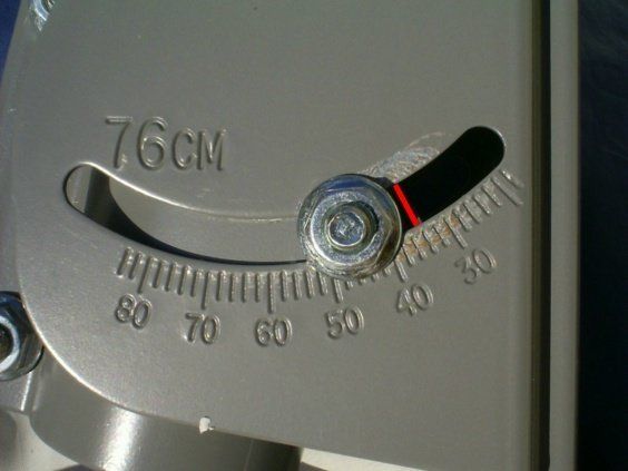

What kind of dish?
If its the Winegard DS2076 make sure to use the red mark when setting the elevation

It looks like your elevation angles and possibly your true south are off.
Follow these steps:
1- Make sure your mast is plump (very important)
2- Make sure the angle on your motor is the same as your latitude (use the Latitude scale on the motor)
3- Start with the dish elevation angle as calculated on our website.
4- With the motor at zero position, make sure that everything (motor, lnbf arm, dish) are in a straight line pointing at True South.
5- Use the receiver's menu to select a satellite ( I usually like to select one that has active transponders and about 10-15 degrees off my Tru south.)
6- Now use USALS (most accurate and easier to aim) to move the dish to that satellite.
7- Adjust your True South angle slightly first, then adjust the dish elevation angle slightly until you get a peak signal/quality.
