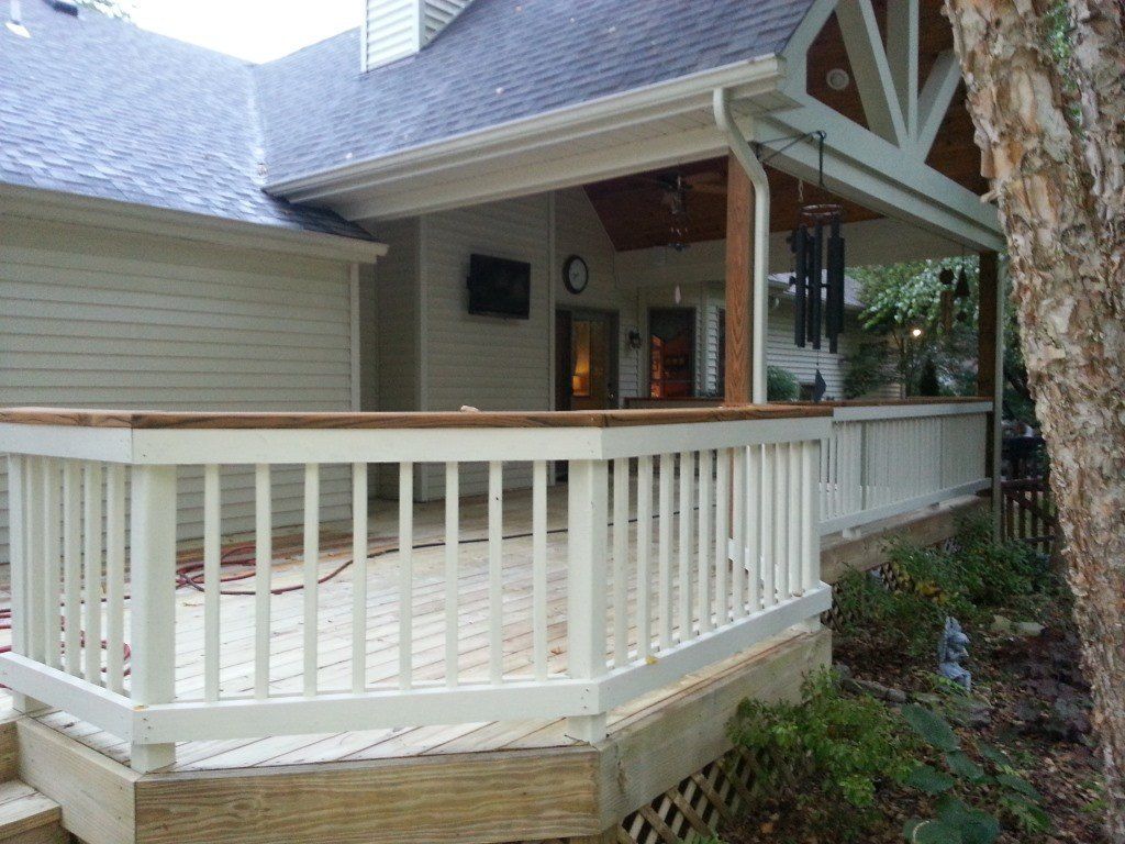

Here is a picture of the porch and chimney. The dish is not visible in this shot - it is on the other side of the chimney.
So you are talking about mounting it on the post along side the downspout?

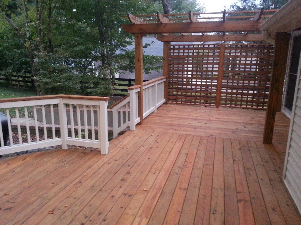

No sir - actually they would have to mount it on the trellis that I built on an adjacent part of the deck. Pictured here, but on the opposite side so it won't be visible when I am on the deck. Looking towards the privacy screen you are facing almost due south.
I would just leave the existing coax in place that runs up to the chimney mount, and then relocate it if I have a problem when the trees leaf out. Who knows, maybe we will get a spring storm to come along and do some "pruning" for me.
The installer may be hesitant to mount it there. Again, maybe a pole mount would work better?
Chip, do you mean a pole mount that would have to be set in concrete in the ground? Hate the idea of having another pole to mow around, and then I would have to take it out if I relocate it. Guess I need educating - you may be referring to a pole mount that attaches to an existing structure - is that right?
Would they hesitate to mount it to the arbor because of stability issues? This thing is built like a brick s##thouse - 6x6 posts set in concrete. It would be as stable as any pole mount system.

If they can get a clear line of sight from the arbor and if it's stable, they may well use it. I was referring to a pole in the ground. It might be inconvenient to mow around, but better that than having to move it later if/when the leaves get in the way. Besides, it's unlikely the installer will put the dish anywhere it would be blocked by incoming leaves.
