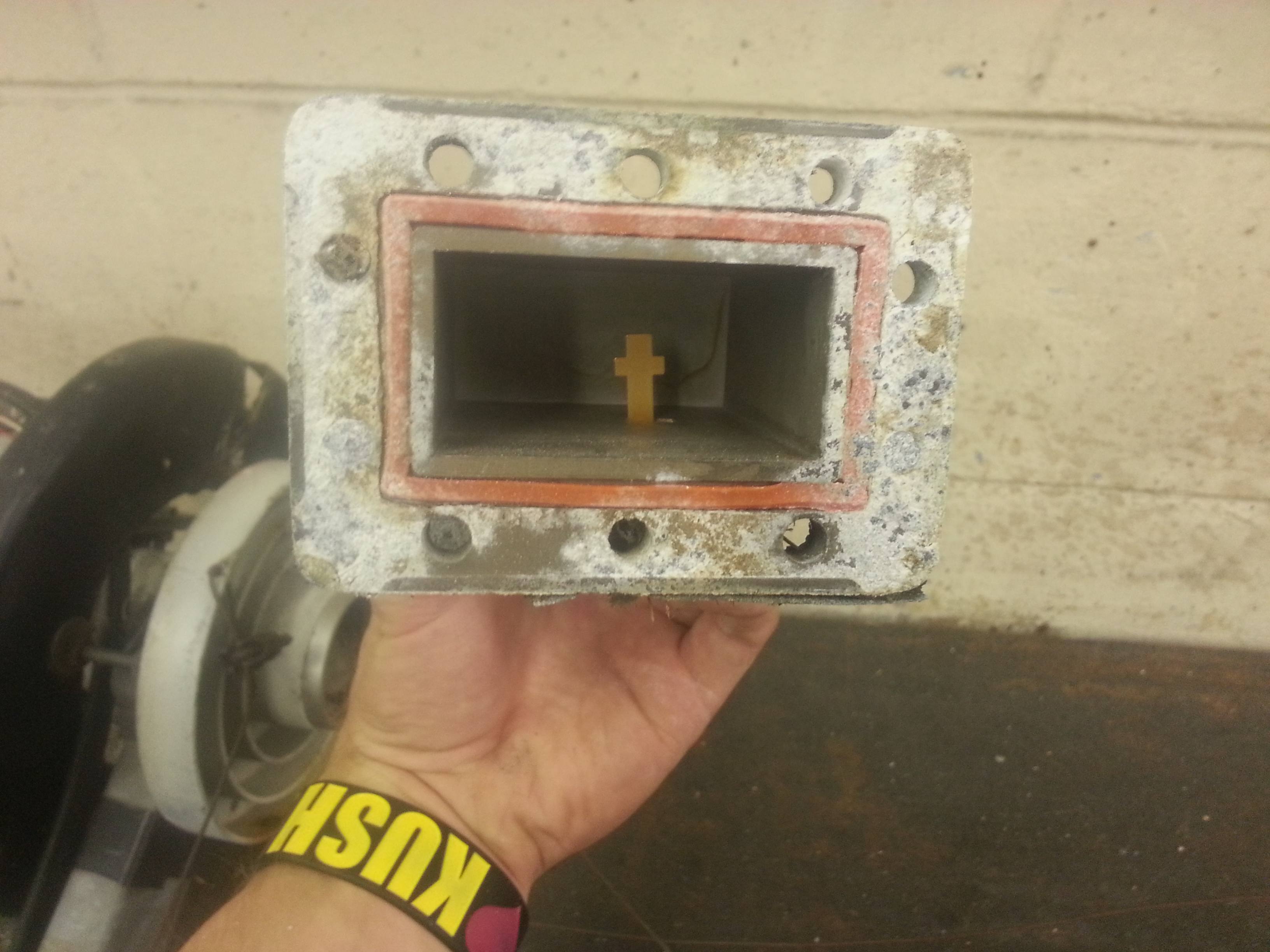

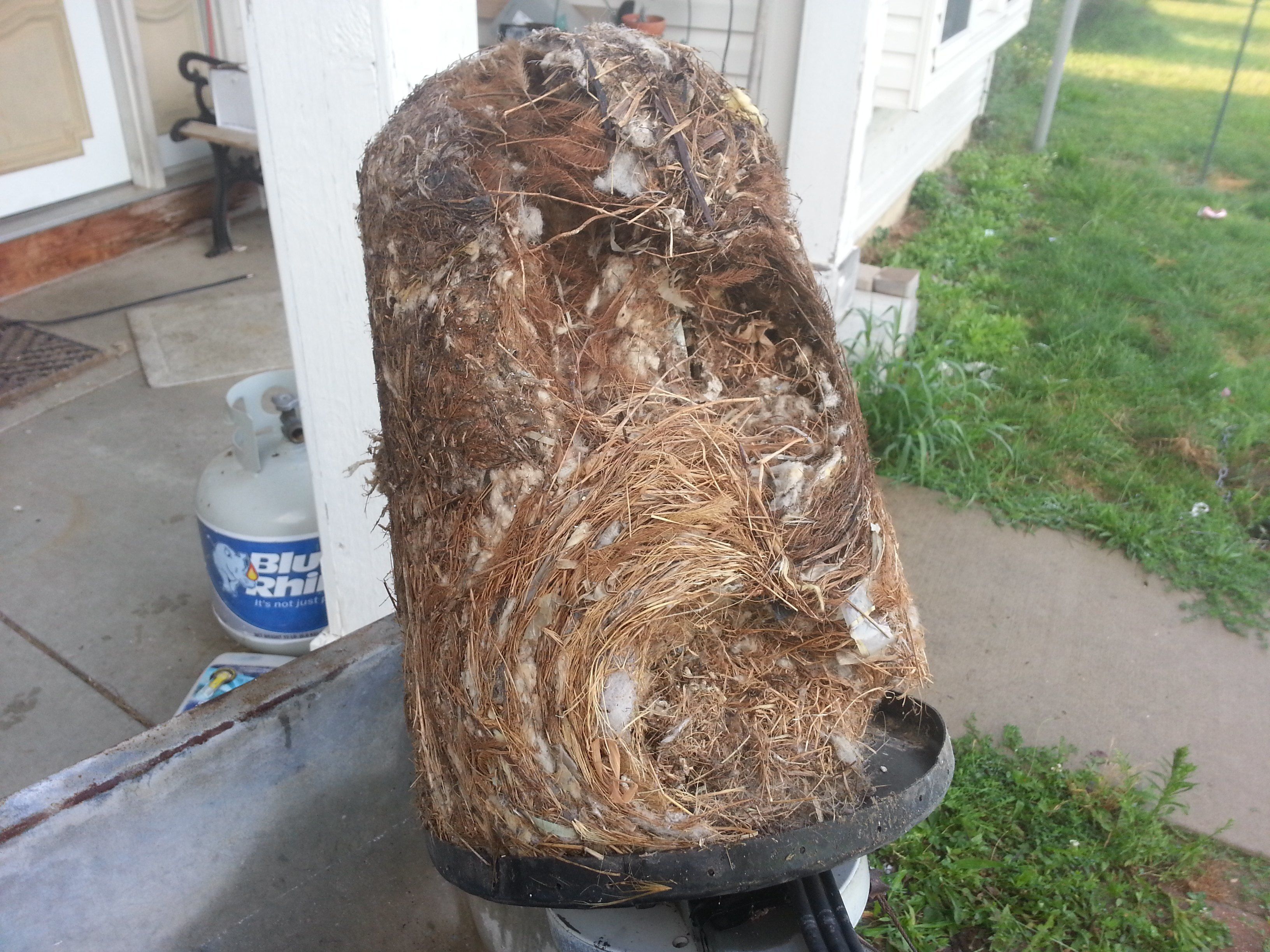

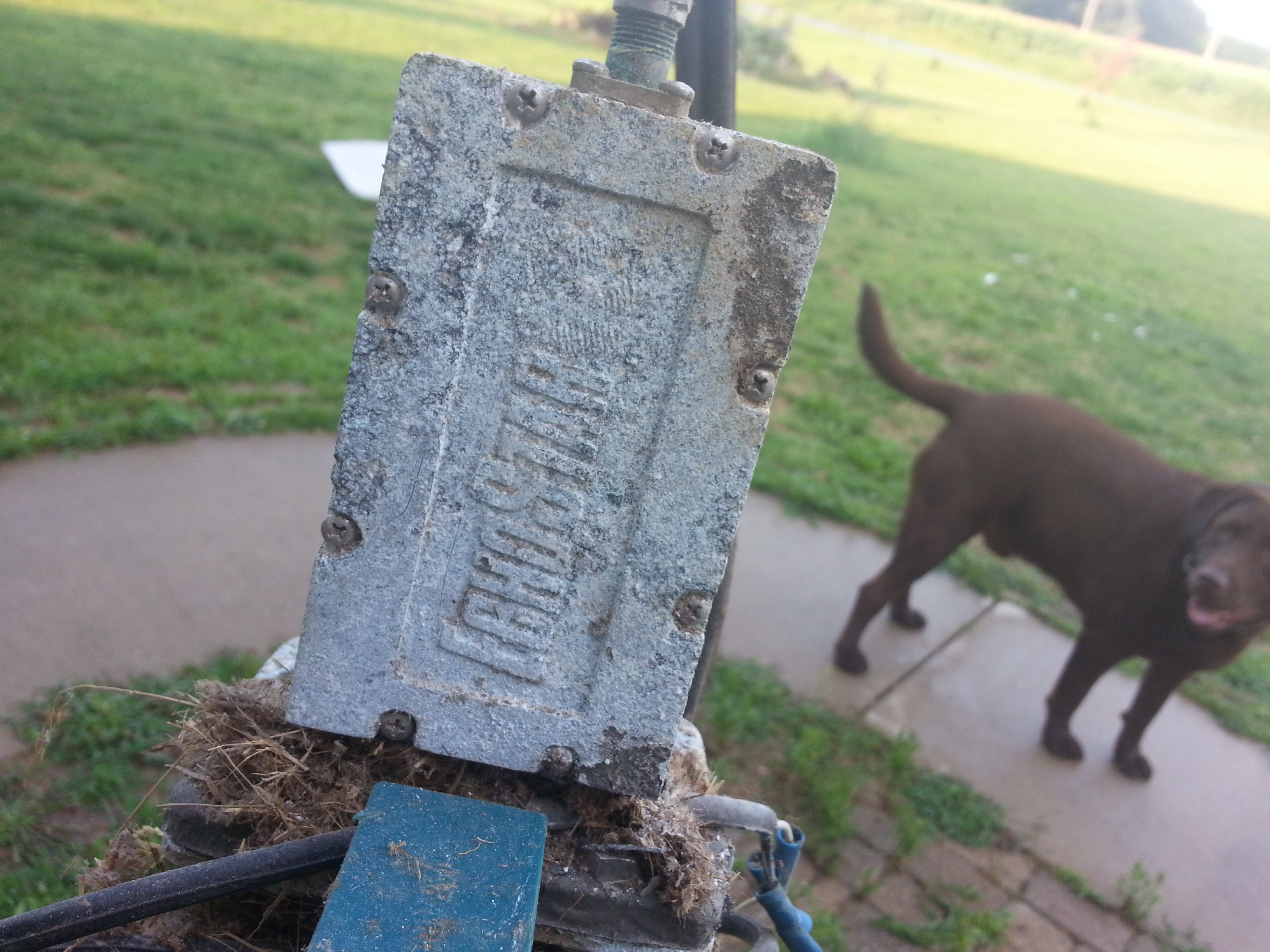

I finally got a pole and time to work on the dish. I took the LNB apart and it was filled with a bird nest. Is this still operable or should I replace it? 20130807_194412.jpg20130807_194631.jpg20131017_124704.jpg
Just clean it up, probably still works. Notice the chamber with the little brass cross (driven element) is still clean due to the gasket. This is the business area.
