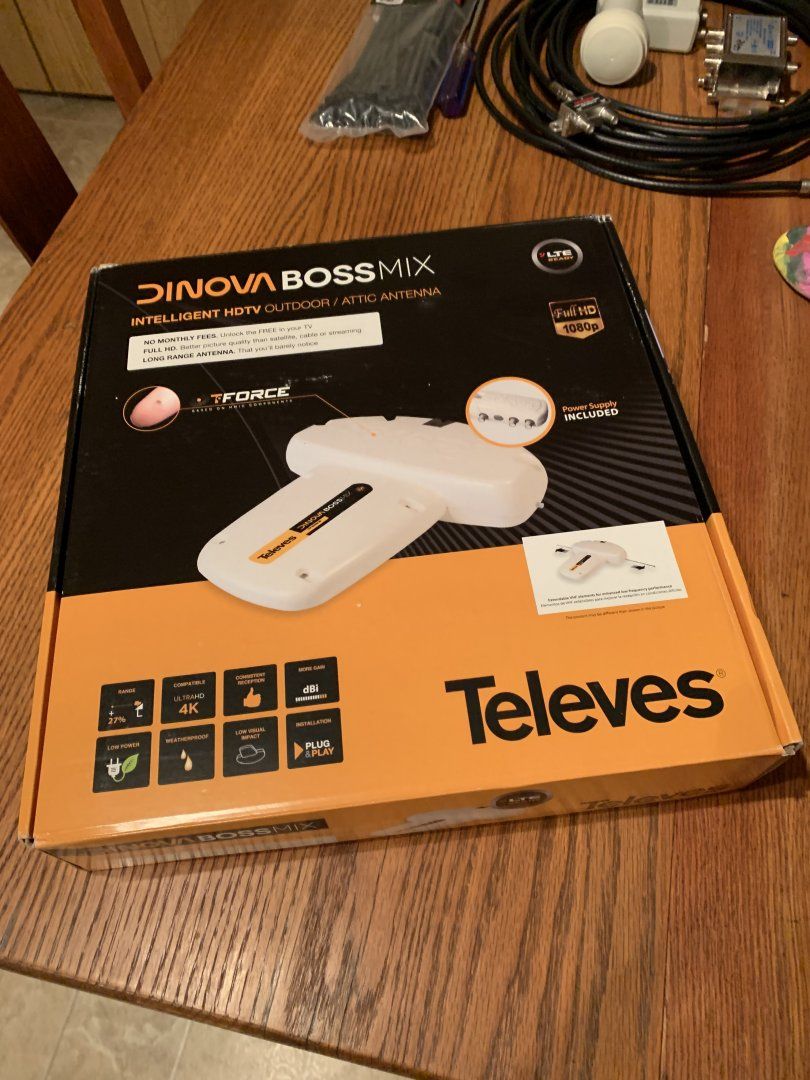

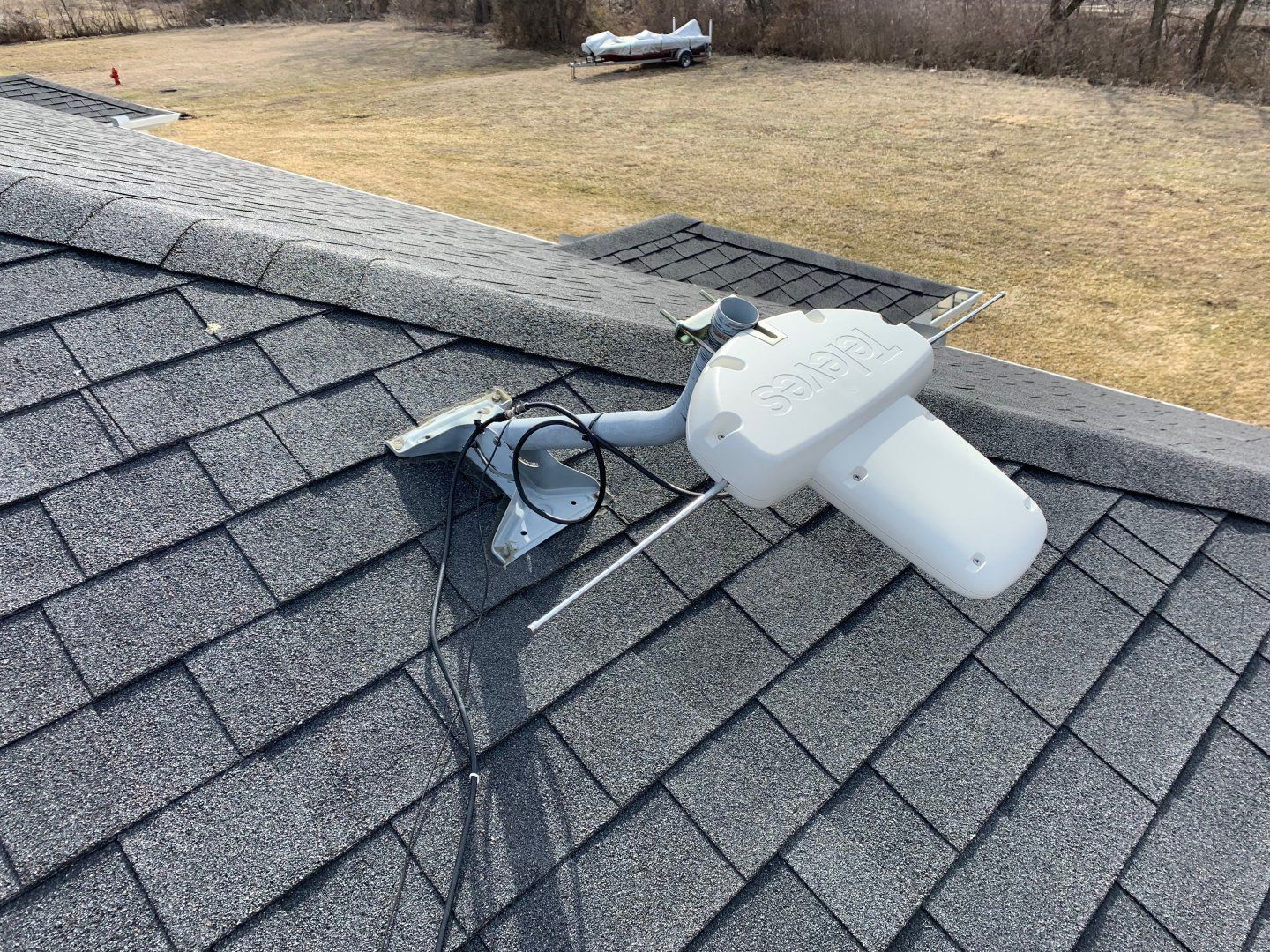

Recently, cpalmer2k posted information in the Dish forum about a new antenna from Televes. It is called the Dinova Boss Mix. It seeks to improve upon its predecessor, the Diginova Boss.
Based on a review I read at Solid Signal, I decided to give it a try.

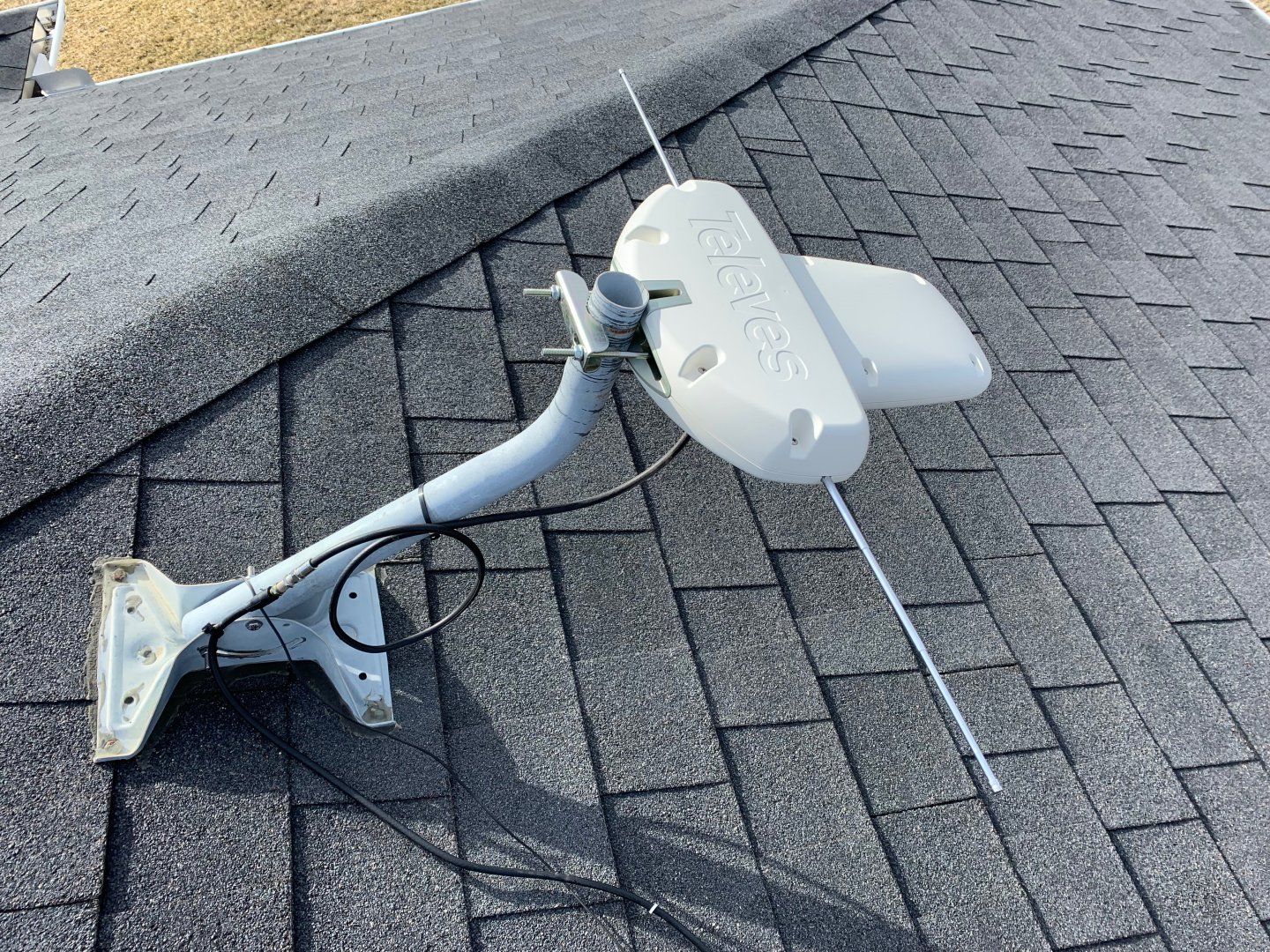

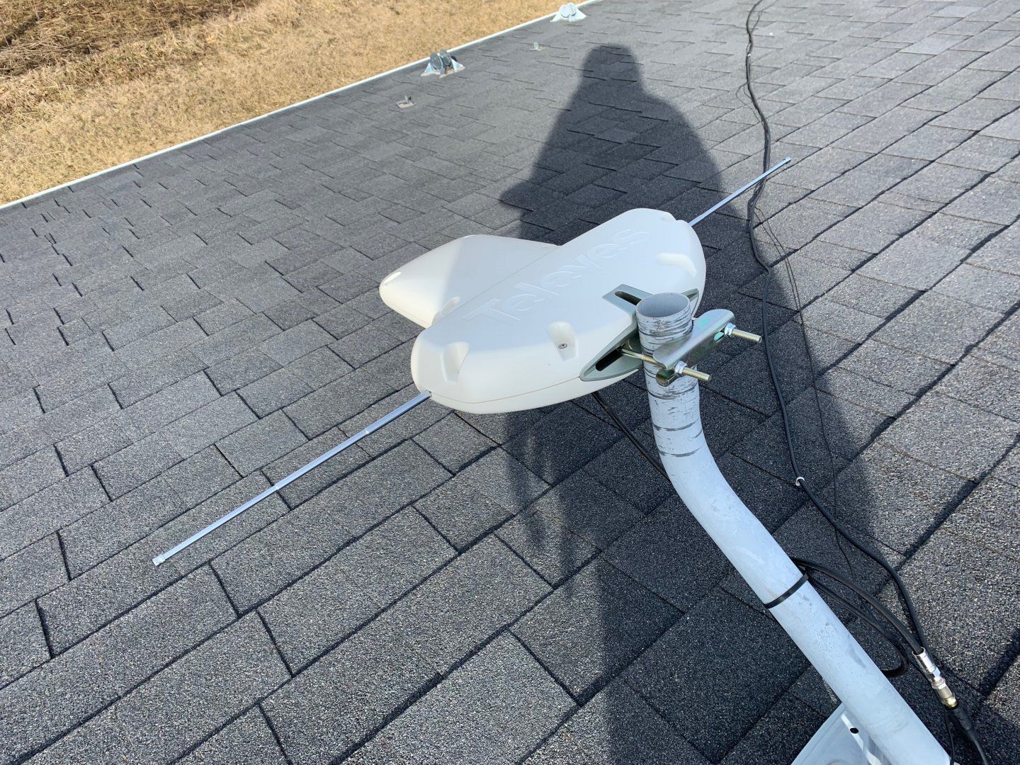

The most notable difference between the older antenna and this one, is the appearance of two "rabbit ear" side lobes for VHF (see photos).

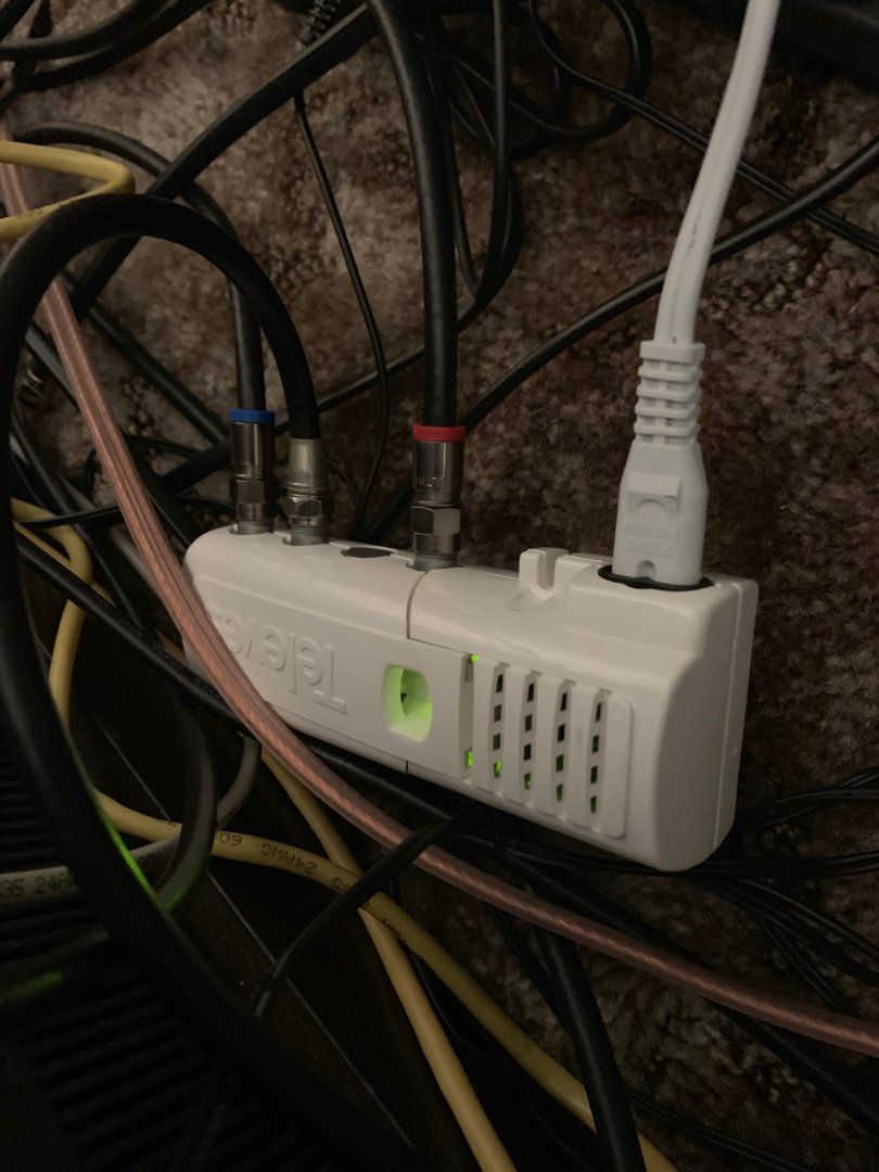

The included preamp is placed inside the building and has two output ports, which eliminates the need for a two-way splitter (and saves you the insertion loss).
The antenna is extremely easy to install- all you have to do is extend the rabbit ears, slide the bracket through the holes in the back, and mount it on a standard J-pole.

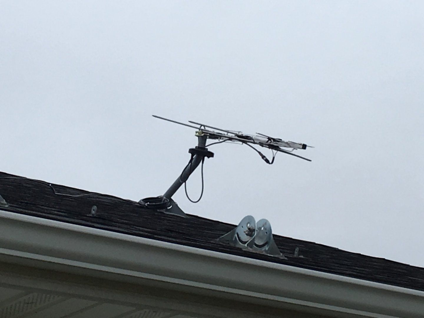

Signal strength and quality are comparable or slightly better than my former antenna, an RCA ANT751R with Channel Master HD7777 preamp.
The antenna was purchased brand new on Ebay for about $50.
I believe this antenna would be good for anyone who wants the signal strength of a small yagi, but doesn't want to spend a lot of money on a preamp.
To be honest, I am surprised at the results this antenna is giving. I am located approximately 45 miles from my TV towers. If anyone is interested, you can view my real-time signal strength and quality data here: RabbitEars Mobile

So, is the VHF portion of the antenna, just a simple dipole? If so, you can get stations 45 miles away on that? I don't see any VHF stations on your chart, so I wasn't sure.
You're right, there aren't any VHF stations in my area. Occasionally I would receive WIBW and KTWU from Topeka on the RCA ANT751R, but that's very rare. So correct, I have no way to test VHF reception on this unit. However, I will note that certain weak UHF stations seemed to increase in signal strength with the dipoles extended, so I left them that way.

I have the older version of that antenna and it's been hassle free for 3 years now feeding tvs at my house and my neighbors. Probably a dozen tvs total. I have it on my detached garage and the power inserter in the garage.
Question...did you plumb the mast after you took the picture or leave it like that? From the literature and other installations I've seen it seems like you have it pointed into the ground if anything...
I don't have much in terms of vhf in my area or I would consider buying one of these.
It's pointed downward on purpose; my house is in a valley and for some reason pointing the antennas downward always yields better results here. Beats me as to why. It also worked that way when I had my yagi antenna on the same mast.
I've had this antenna up since March 10th and it performs like a champ. Very consistent signal levels. It gets significantly higher readings on 2 UHF channels I always had a hard time with on the yagi. I'd say the "Boss" passes muster :)

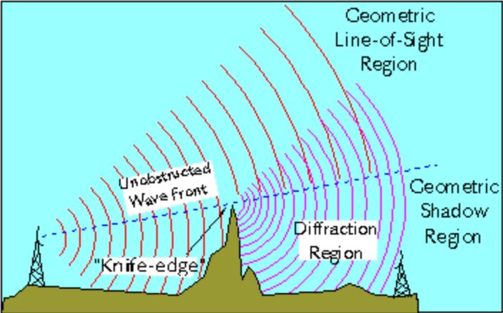

Yep, tv reception can be a real challenge. We have a large hill with a treeline across the top between us and the towers over 40 miles away. I have to point the antenna up a bit to take advantage of the knife-edge effect. If I point it level we lose some stations. :rolleyes:
