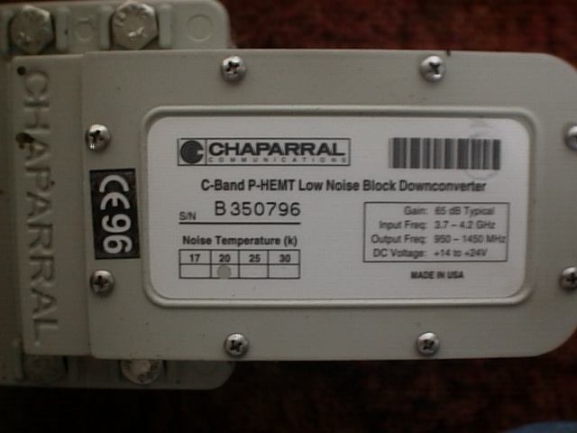

My new equipment
OK I've picked up my new dish and it appears to be in excellent condition. I hoped to be able to get more pictures but ran out of batteries for the camera.
Dish:
Unimesh 8 foot fine mesh (openings about the size of tip of ballpoint pen)
Actuator:
VonWeise
Feedhorn/LNB:
Chaparral
C-Band P-HMET Low Noise Block Downconverter
Noise Temperature 20k
Gain 65dB
Input Freq 3.7-4.2 GHz
Output Freq: 950-1450MHz
Ku-Band PHEMT LNB
0.7dB
Gain 56dB
Input 11.7-12.2GHz
Ouptut: 950-1450MHz
LO Freq: 10.75 GHz

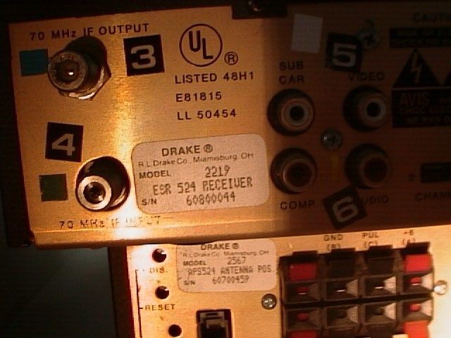

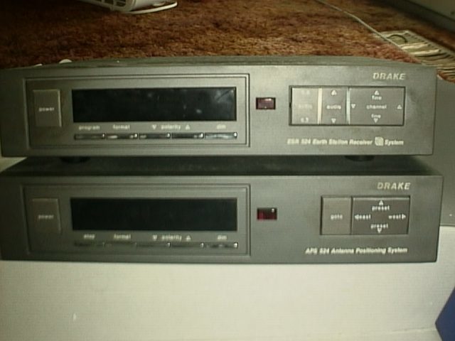

Reciever:
Drake
ESR 524 Earth Station Reciever
Model: 2219

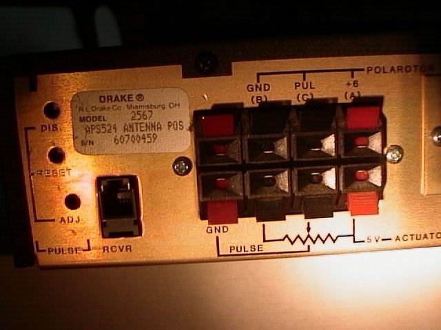

Positioner
Drake
APS 524 Antenna Positioning System
Model: 2567

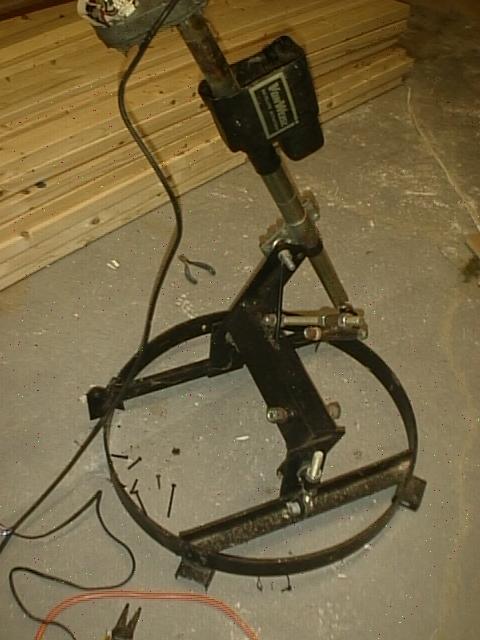

missing part?
Well I've had a few minutes to take a closer look at my mount and I'm pretty sure that it's missing some parts. I don't see how to attach it to a pole. I also tried out the actuator which didn't work. After taking it apart I discovered that the magnet in the motor is smashed into about 10 pieces so looks like I will be getting a replacement.

Looks like a nice deal. Your mount will attach to the Eight foot reflector with 4) 3 1/2 inch bolts quarter inch thick (I think) but it will be worth putting up.
