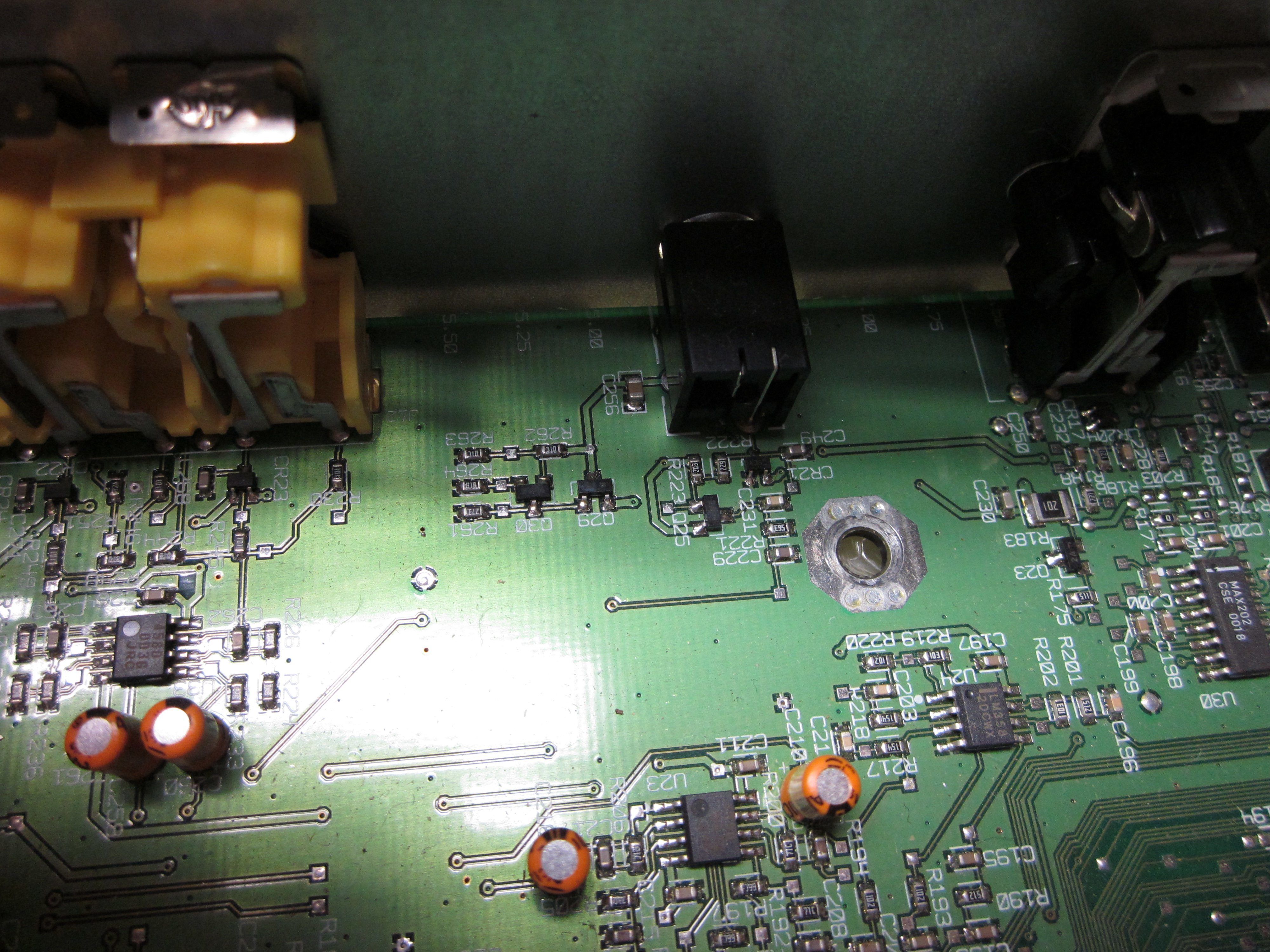

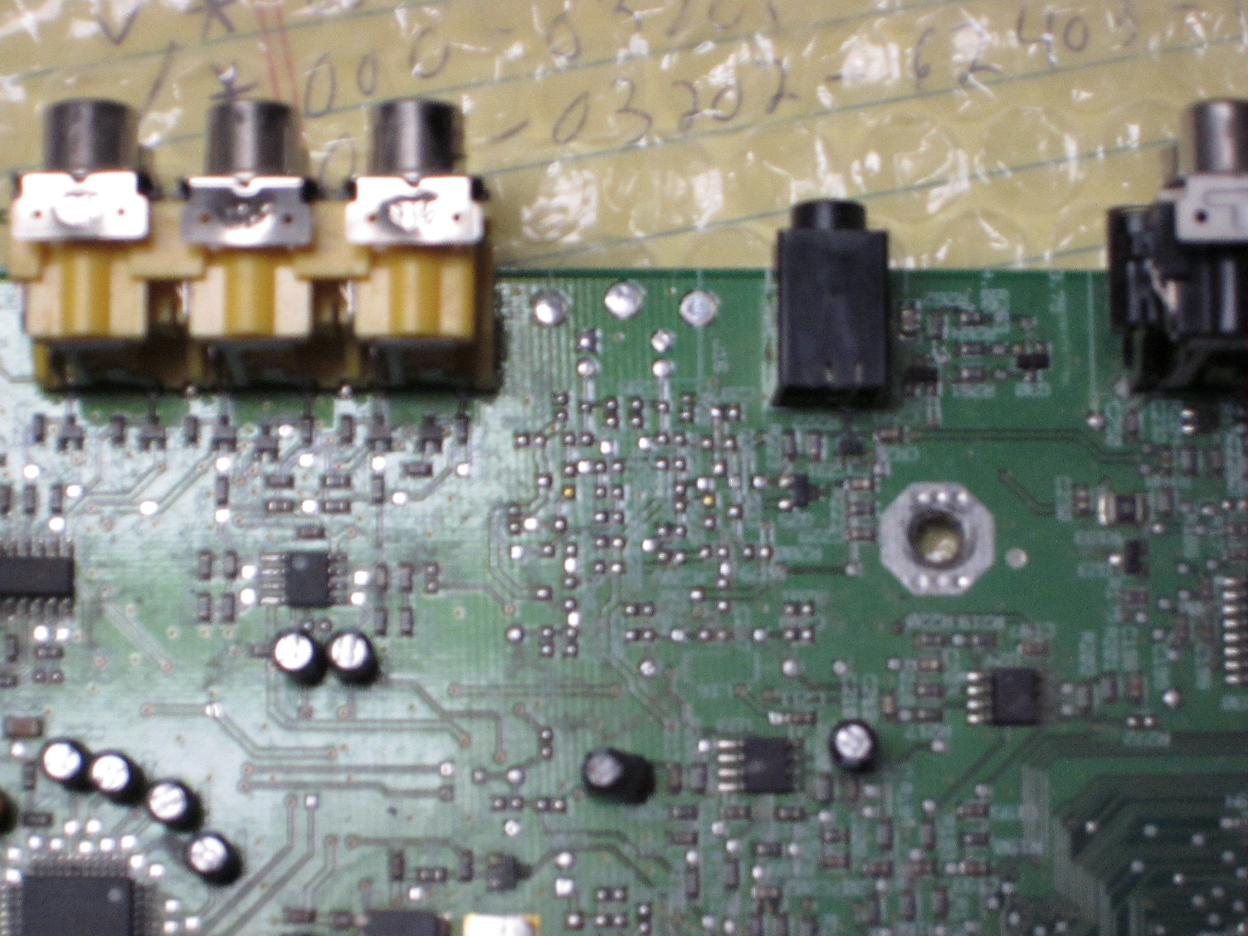

I think that some model 410's can have an s video added to them.
I will explore this more and post details that would be killer if you ask me.

My 405 has S video its basically a satellite only 410. The 410 has a qam cable tuner also. You would probably need to look at a unit with s video already and see where they are taking Y&C from. Then build a buffer amp for each Y&C.

Can't remember but the mn or ds model has the room on the borad for svideo just needs the parts the other does not.
I was going to use my hot air rework station and remove the components on a 405 that has a bad ID and transfer to the 410 board and see what happens.
pics of different 410's

I'm sure the video is in a pure Y & C state before they combine it to composite out. A 470 pf cap will allow the two to combine. So just follow composite back to where it splits back to a Y C state. Build a couple video amps with dc clamp restored after cap coupling the stages and your good to go.
