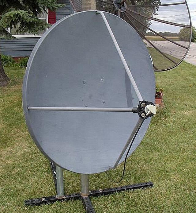

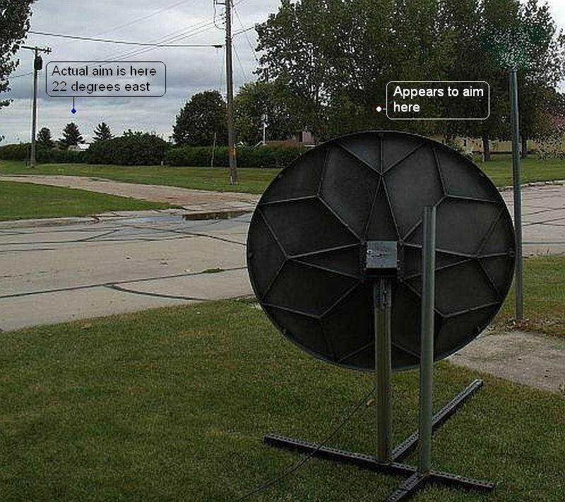

Won't the mount allow it to go below 42°? Seems odd, my CM 1.2's are marked to 8° but only get down to around 22° before the bottom of the dish hits the pole. I got one down to 6° elevation by putting the dish on the mount sideways for 30W. How about a picture of the dish, and maybe another of the mount?

Interesting lawn-friendly mount, too! - :up
Must be a bear to aim, though. ;)
105w - look for TP 11856 V 3548 (Macy's 4 - Slate ch. $), Something to aim for anyway.
Yeah, it's a temporary Lawn Mount that's kinda turned semi permanent. Now added a 83e on the second pole for 125W. No problem aiming either. Still working on a polar mount for the 2nd 1.2.
