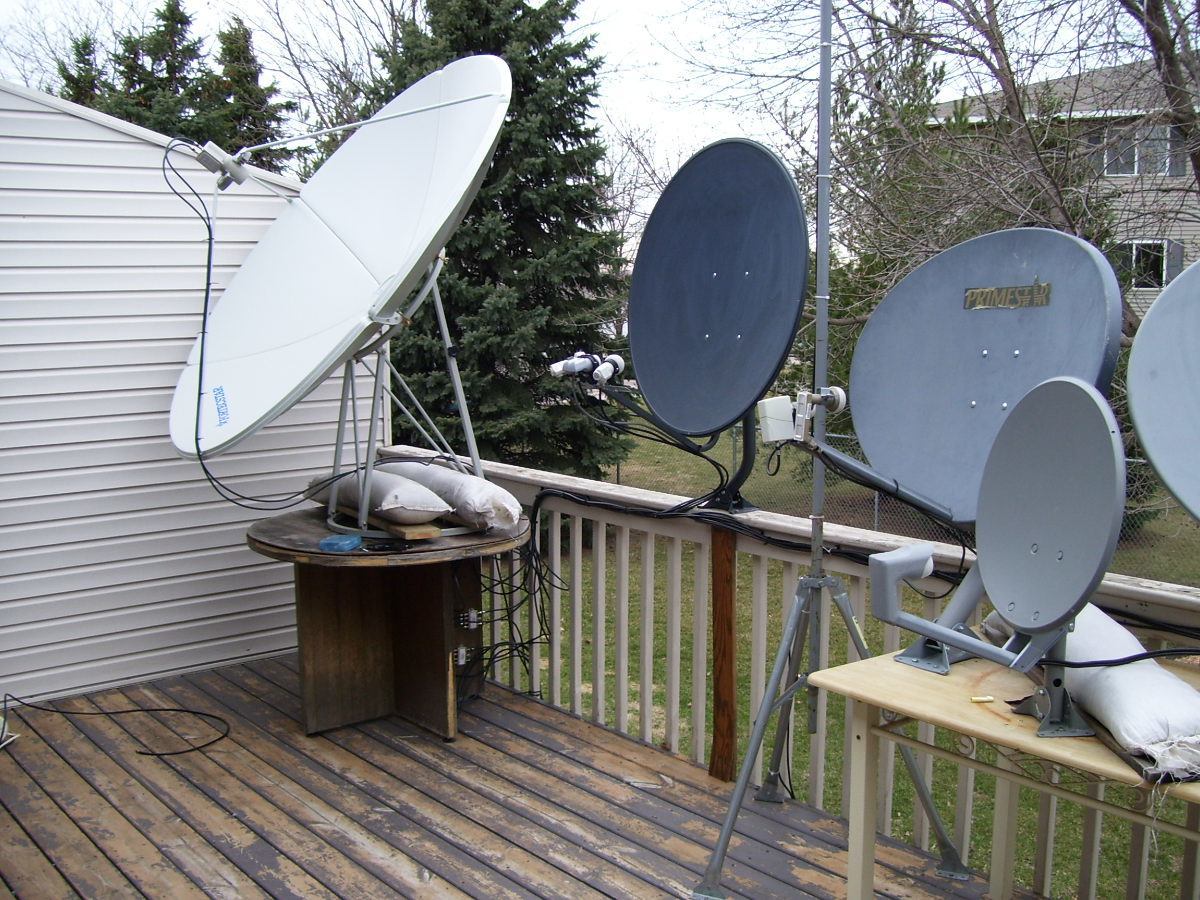

The 22 offset doesnt bother skew. All it means is the dish "sees" 22 degrees higher than what the dish looks like
Below is a perfect example of offset. The dish the farthest away is a 6 foot C-Band dish which is prime focus...which means it looks at the satellite as it should (no offset). Its at my true south, which in Minneapolis is 38 degrees. The dish closer (the dark grey one) is also at true south of 38. Look at the dish how it looks. Looks straight up and down

What Ice was saying is that when you dial your dish to 56º, it appears to be looking 22º lower than it is really receiving a signal from.
So , the dish may appear to be aimed at the trees, when it is actually looking over them.
