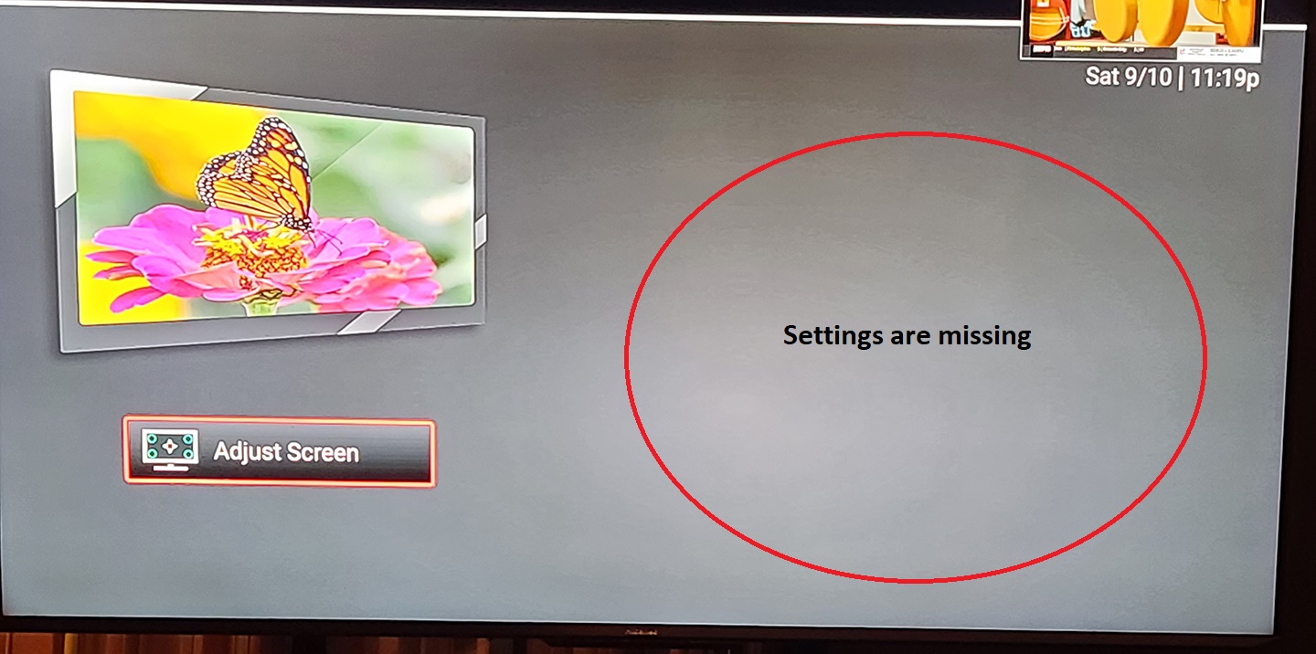

4. Each unit is missing the ability in Dish settings > TV to change the Video Resolution and Aspect Ratio.
I am sure there are other bugs but I have been focused on the video signal at the moment.
