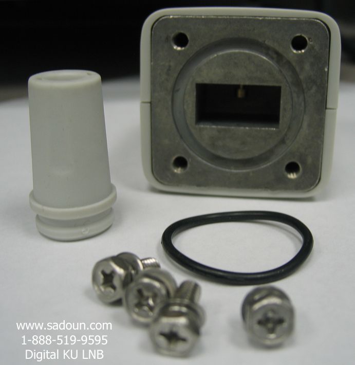

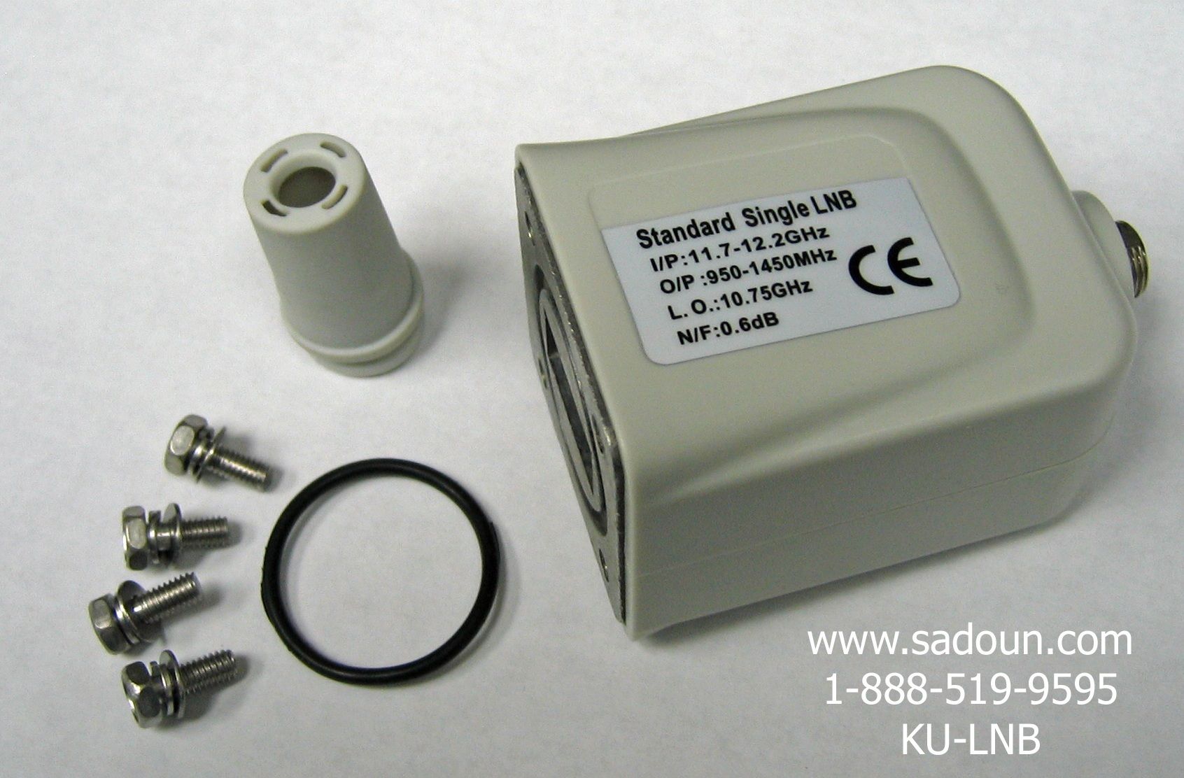

I have a NEW KU LNB available for FREE to anyone that has a C/KU Feedhorn and interested in testing this new LNB.
Only one unit is available.
Here are the details:
KULNB1 replacement KU Band LNB for feedhorn on C Band Dishes
Contact me if you are willing to test this LNB and provide feedback on its performance.
Make sure this LNB will fit on the KU side of your Feedhorn before volunteering.

Voltage polarity control is included in this LNB and confirmed by the factory.
This is an excellent LNB, but before I introduce it to the market, I am interested in expert users feedback on it. I have another unit that I can send to another BUD user.

Are you sure this LNB support 13/18v polarity switching? The reason I ask is it looks like a standard wr-75 flange LNB that would be used on the feedhorn on a big dish and these type LNBs don't do any polarity switching because the feedhorn itself determines the polarity (usually through a probe rotated by a servo) before the signal even gets to the LNB and only the polarity selected ever reaches it. therefore 13/18v polarity switching in an lnb like this would be useless. Also in looking at the photo you attached that shows a view down the throat of the LNB, I only see one probe. How is it possible to have 13/18v polarity switching in an LNb with only one probe? I don't see how this could be possible unless there's another probe we can't see or there's a hidden magnetic polarizer encircling the mouth of the LNB and the LNB is controlling it internally. Are there one or two probes in the LNB? Are you sure the manufacturer isn't just mistaken and perhaps misunderstands what your asking them?
