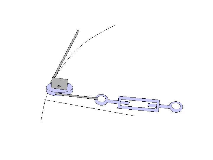

1) A better mechanism for adjusting the guy wires that center the shepherds-hook feedhorn mount. Right now these just pass through holes at the rim of the dish at about 10, 2, and 6 (clock face), and have screw clamps holding them. Pretty tough to do an accurate adjustment. You have to loosen them, pull the cable by hand, and then tighten it without letting it slip. I guess I could use a small vise grip to hold it temporarily while I tighten the clamp, but a vernier screw adjuster of some design would be much nicer. Maybe a pulley block and a turnbuckle anchored to the frame... Anything commercial out there that is recomended for this? I could make something on the lathe... (see crude sketch attached...)
2) A better method for measuring the distance from the horn to the dish rim. SUGGESTION for your consideration: It occurred to me that I could take an old feedhorn cap (or even the new one if I didn't already have an old one), drill a small hole right in the center of it, feed a piece of non-stretch fishing line , or kite string (spectra or the equivalent, which I already have) through the hole and knot it, and then use marks on the string to measure the point to the dish rim. I was using a tape measure, but its hard to get it dead straight, and to find the right place to measure to. The string would always be perfectly anchored right in the middle of the feedhorn throat, and can easily measure right to the face of the dish. What do you think?

1)i like the idea of turnbuckles for adjusting your guy wires, should work awesome.
2) i think the string idea is a good one, you could also use a laser pointer if you can get it perfectly aligned on the feedhorn cap.

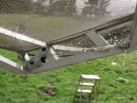

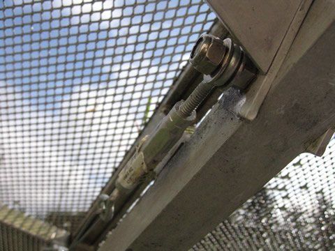

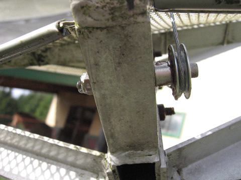

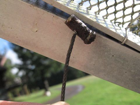

I went ahead and built a pulley and turnbuckle adjuster for my sat dish and took some pictures. This is a 12' Paraclipse dish.
The first picture shows the rusted original guy wire clamp which was not conducive to precise adjustments.
The next three show the mounting of a ball bearing pulley, and turnbuckle to make adjusting the feedhorn guy wires much easier. I only had to drill one new hole in the frame for each of four guy wires. The turnbuckle mounted on longer frame bolt to give it some clearance from the frame.
