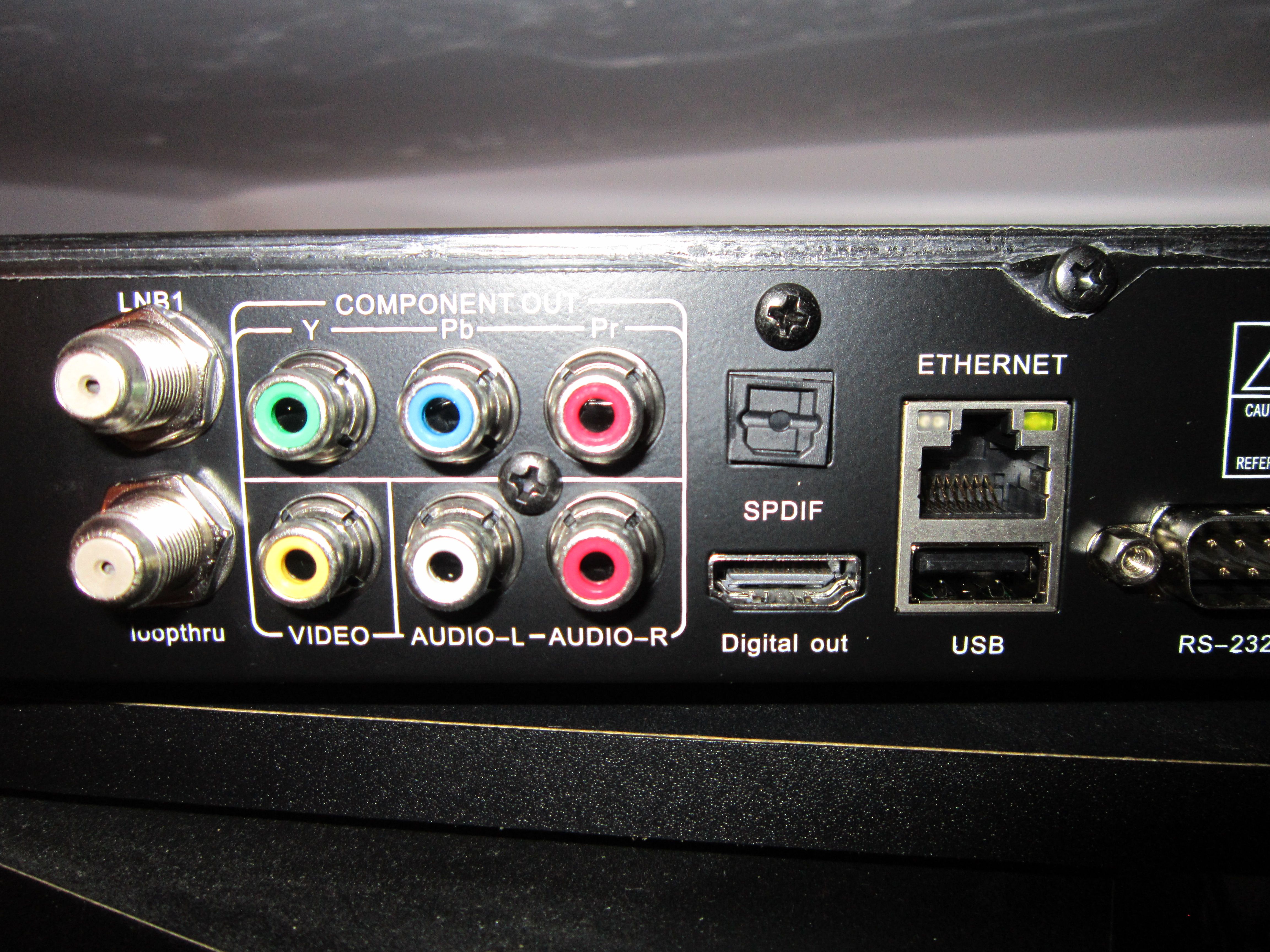

The Linkbox 9000i manual shows an Hdmi port. The enclosed picture
of the Linkbox 9000i I have shows a Digital out port.

That digital out port looks like a HDMI, if your HDMI cable fits into that one, try using that one.
Thank you for responding Raine.
That's exactly what I did and no luck.
I am using the old cable from the Openbox.
Surely that couldn't make any difference!

Shanklej,try the HDMI cable that came with the Linkbox.Then cycle thru the HDMI choices on your tv until you find the 1 with the linkbox menu showing.
If that doesn't work....
Power off both the TV and the 9000i. Connect the HDMI cable from the 9000i "Digital Output" port to the TV HDMI port. Power ON the TV and select correct HDMI port. Power ON the 9000i. In approx 30 seconds the two devices will shake hands and negotiate the correct resolution.
If no video appears, connect a yellow RCA video cable between the 9000i and the TV. Switch the TV to the composite input.
Once the STB menu displays on the TV, go to the TV setup menu and change the resolution to the highest compatible setting (example: 1080p_60hz). This manual setting will be preferred over the default "Auto" setting.
