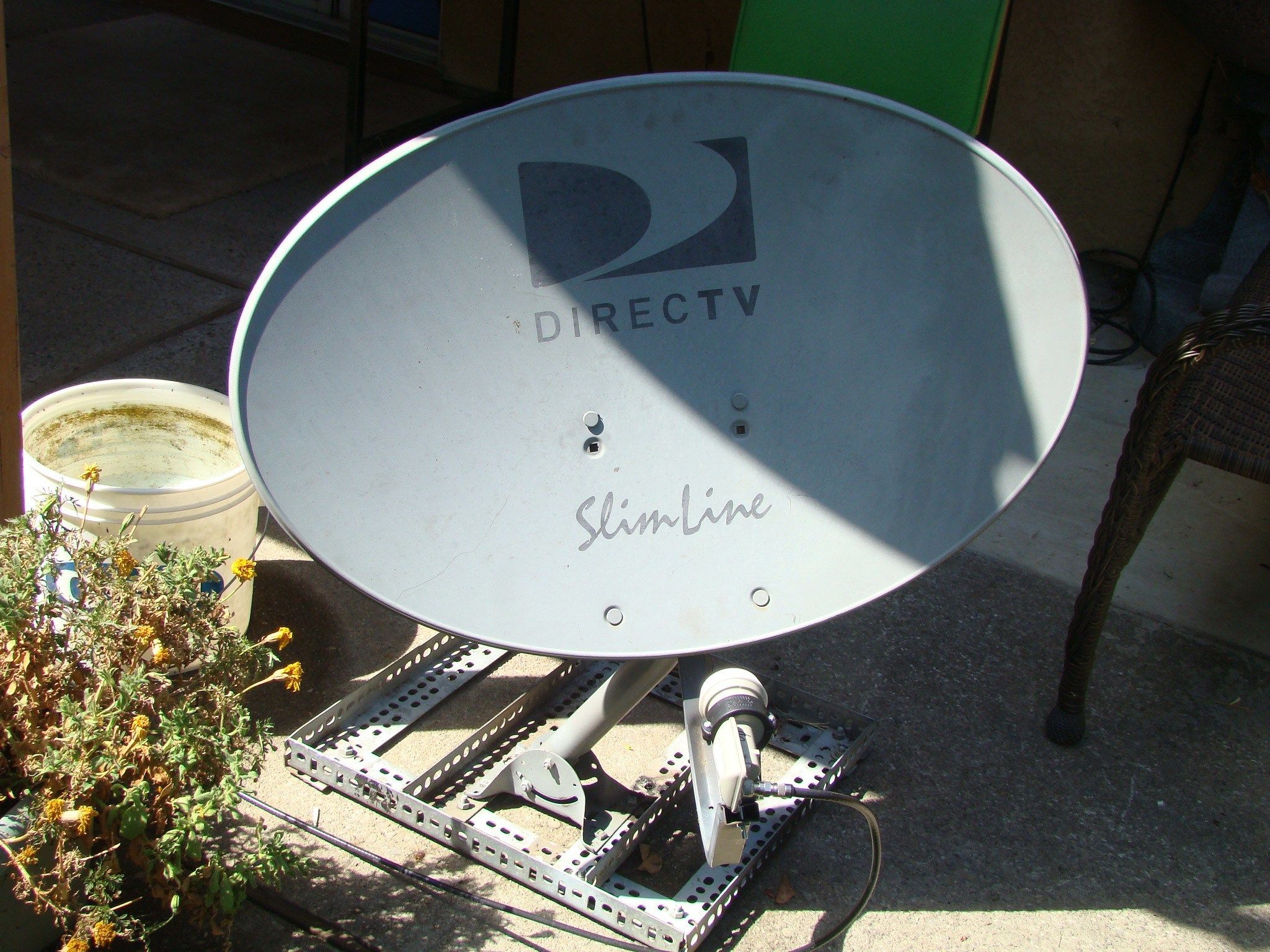

Testing a XtreameII KU LNBF rated at .3 db RF 11.7-12.5 GHZ IF 950-1750 GHZ LO 10.750 GHZ
I purchased 2 from a seller on ebay for $11 includes mounting bracket and shipping. These really perform on a small offset dish. Still testing but so far out perform other LNBF on the market.

Please post your testing results and information about the equipment used, satellite, frequencies, weather conditions, etc. Be interested in what you compared and the results.
LNB on offset dish
Testing AMC1 KU getting enough signal to support the music channels on 12144 ghz.
Was able to use a scrap Direct tv dish and glad there is surplus around. The dish size is 23x32 inches. LNBF Xtreame.
We've seen threads using this dish before.
Not really promoted, but plenty adequate for many applications.
LNBF shouldn't really be critical.
I see you mounted yours sideways. ;)
Recommend this thread be moved to main FTA area, as it's not C band related.
Noticed the weaker tp's come in better with extreme lnb vs regular lnb and have tested 4. All work identical and appear to be made for small offset dish like DirectTV slimline etc.
