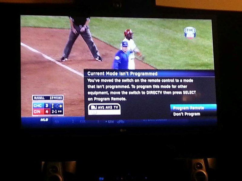

I did as you wrote several times. This is what happens when I press channel up.

You don't access that screen, hold mute and select until the lights flash and then enter the code :)
I think I am missing something. When I press mute and select, that message appears. The lights flash as you say, and I input the 991 then 9 and channel up. It doesn't take. I have tried it with the slider over Directv and TV. I have tried both codes here (The remote is RC65RX). Could it be the CE software?
Arite hold mute and select with the mode switch on tv. Ignore anything that comes up on the screen. The lights flash twice. Enter 10178. The lights flash twice again. Now hold mute and select again. Again ignoring whatever shows on the screen. Enter 960 and count how many times the light flashes. If it flashes twice your done. If it flashes 4x. Then hold mute and select one last time. Enter 960 again. It will flash twice. Slide the mode switch back to directv and just say program later or hit exit to clear the screen. Your remote is now programmed.

Thank you. That worked. Epically too complicated! Thanks again.
