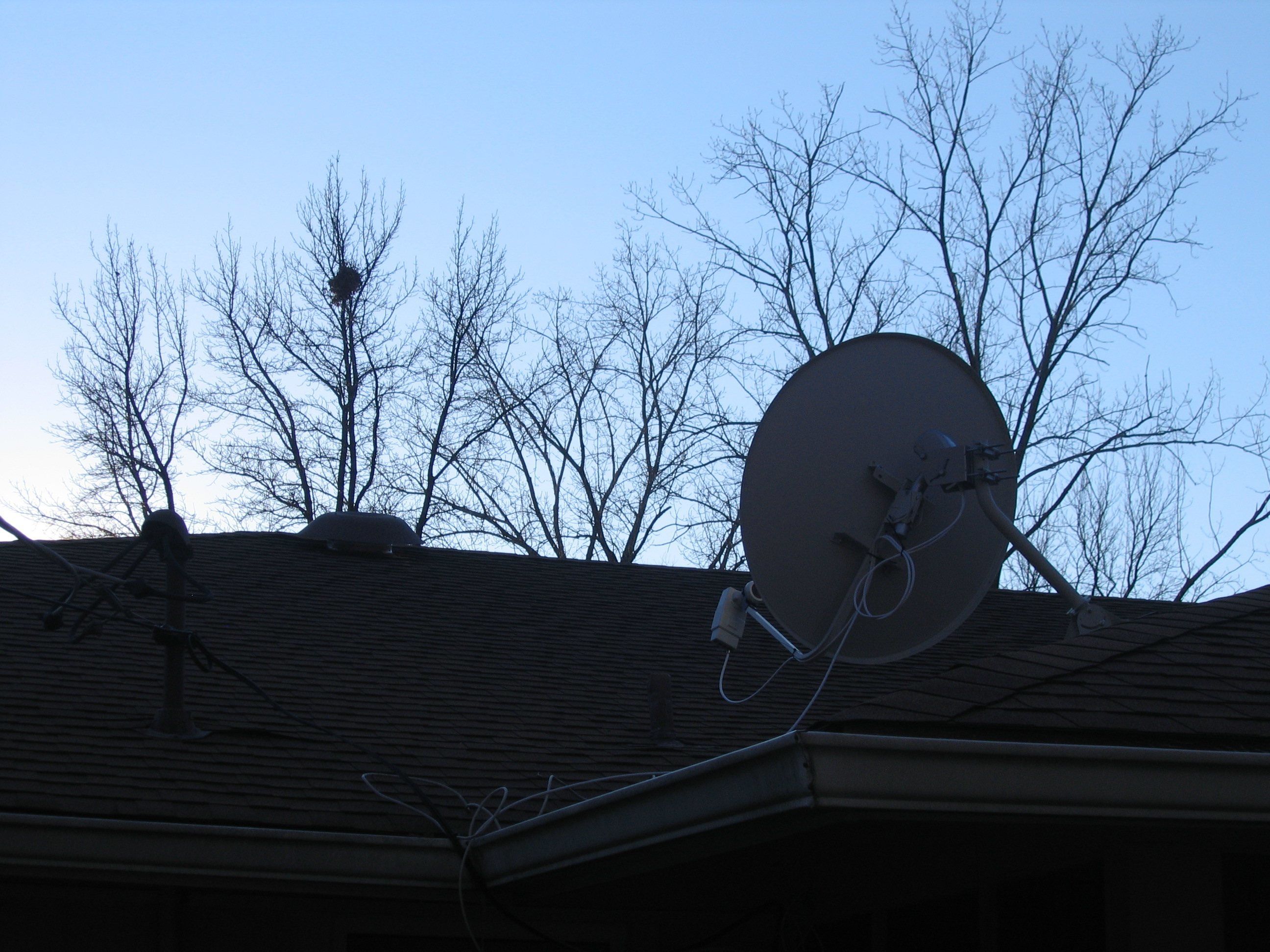

AMC 1 103 is the farthest I get to the west. I can not get G10r at 123. I have attached a piture pointing at 123. I am pretty sure it is not pointing at the trees although it looks like it in the pictures. I think it is clearing the roof and it was plumb. I am happy I am gettign channels especially Russian Today but would like G10r and others past 103.
What are your thoughts? Should my beginning sigal quality on G11 be higher. It might help with Al Jazeera unless I am doing something else wrong but what about G10r.

Maybe just some more tweaking on the settings of the dish. It's best if you can take a small tv close to the dish while you adjust, so you get instant feedback. I get stronger signals on G11 and Pentagon esp with a 1m primestar, so maybe you just need to adjust the elevation or the north/south a bit on the pole. You're very close to having it though!
HI,
To get Al Jazeera English on G25, I recommend you do a FULL scan. The channel for some reason is marked as scrambled, even though it is FTA. So if you just do a scan for FTA channels, you will not find it.
The best way to a ign a motorized dish is to use the USALS feature of your receiver and motor. It is more accurate and faster than using DiSEqC 1.2
Since you got so many satellites, you are on the right track. Just a little tweaking might be in order.

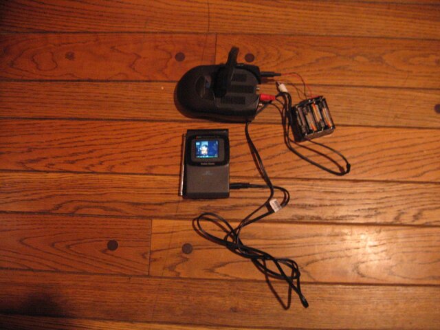

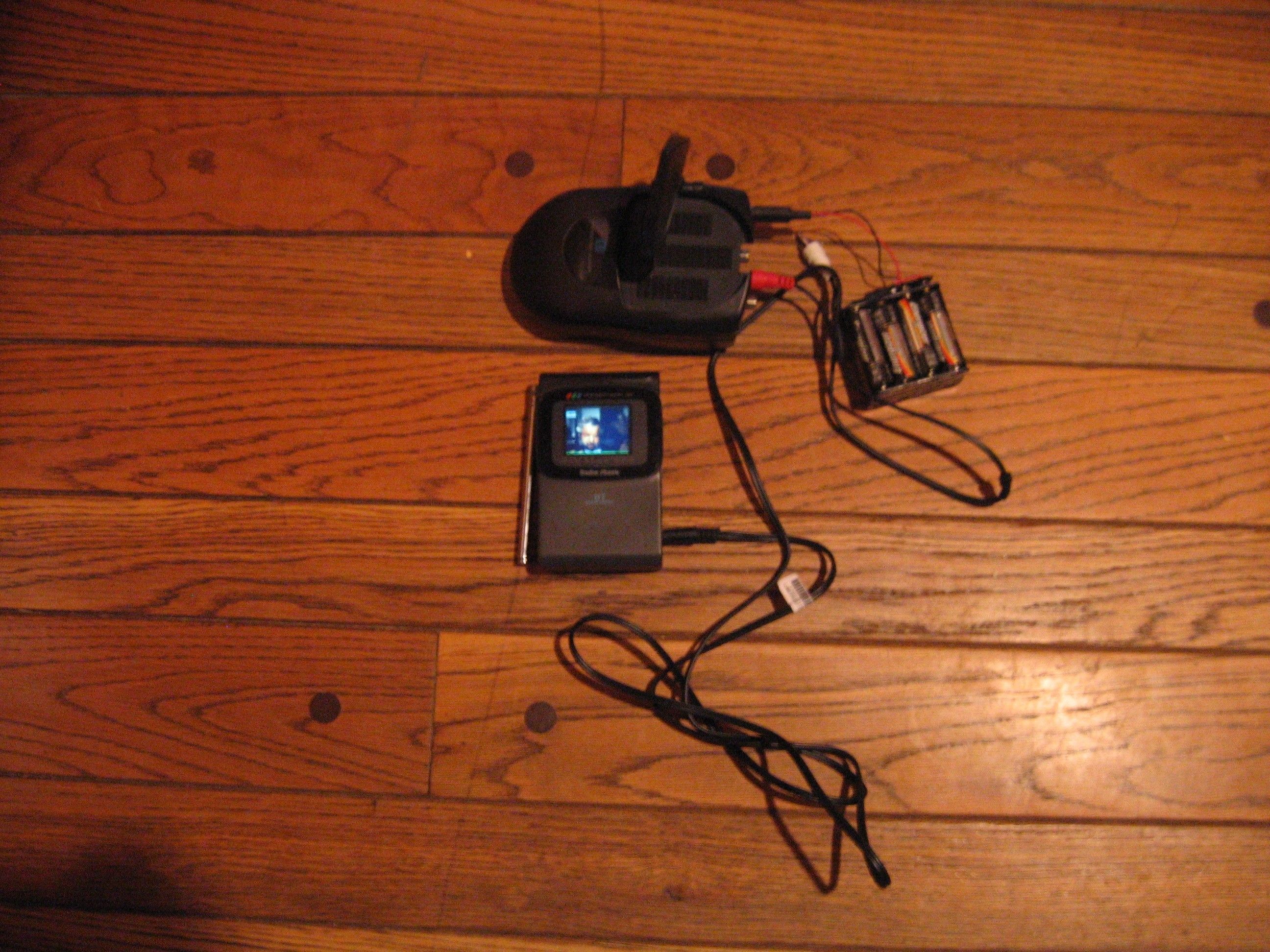

I actually had a small tv on the roof. Its so small its hard to see. I need to find a bigger barttery powered video display. I went to Gateway electronics and got some battery holders and a jack and made the battery pack for the wireless video receiver. I had everything else. If your ever in St. Louis check out Gateway electronics they have all kinds of electronic componants.
Any one else have any ideas. I will try and tweak again tomorrow. Should be a little warmer and less windy.

HI,
Thanks Sadoun.
I bought the stuff from you.
I will try that and I am using USALS.
